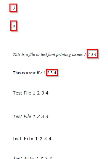

We have seen that the files we generate (with font subset embedding) will print to paper perfectly correctly when using the latest version of Acrobat Reader DC or Acrobat DC. However, we noticed that some fonts change upon printing to paper when using Adobe Acrobat XI or Adobe Acrobat 2015. I am attaching an example file, as well as how it got printed depending on the version of Acrobat used. You can see that the font changes upon printing when using Acrobat XI or 2015.

This time around, I am attaching a file with a bit more text (and also it's the original file that our system generates - I had run the previous file through a random library last time, as you saw, to see whether pinting issues would still occur, which they did). Reproducing this issue is hard, and we haven't found a good pattern, but it seems Times New Roman numbers are easily affected. Customers have also reported issues with some Japanese text and associated Japanese fonts as well. On our side, Times New Roman is the easiest to reproduce with.

FontPrintingIssue_original.pdf : the PDF file our system generates based on the above Word file. It prints to paper fine with Acrobat 2020, but the fonts change as per below image in Acrobat 2015.
FontPrintingIssues_WhatChanges.png : within that sample file, the characters that have their font change when printing (from what I can tell) when the problem arises
