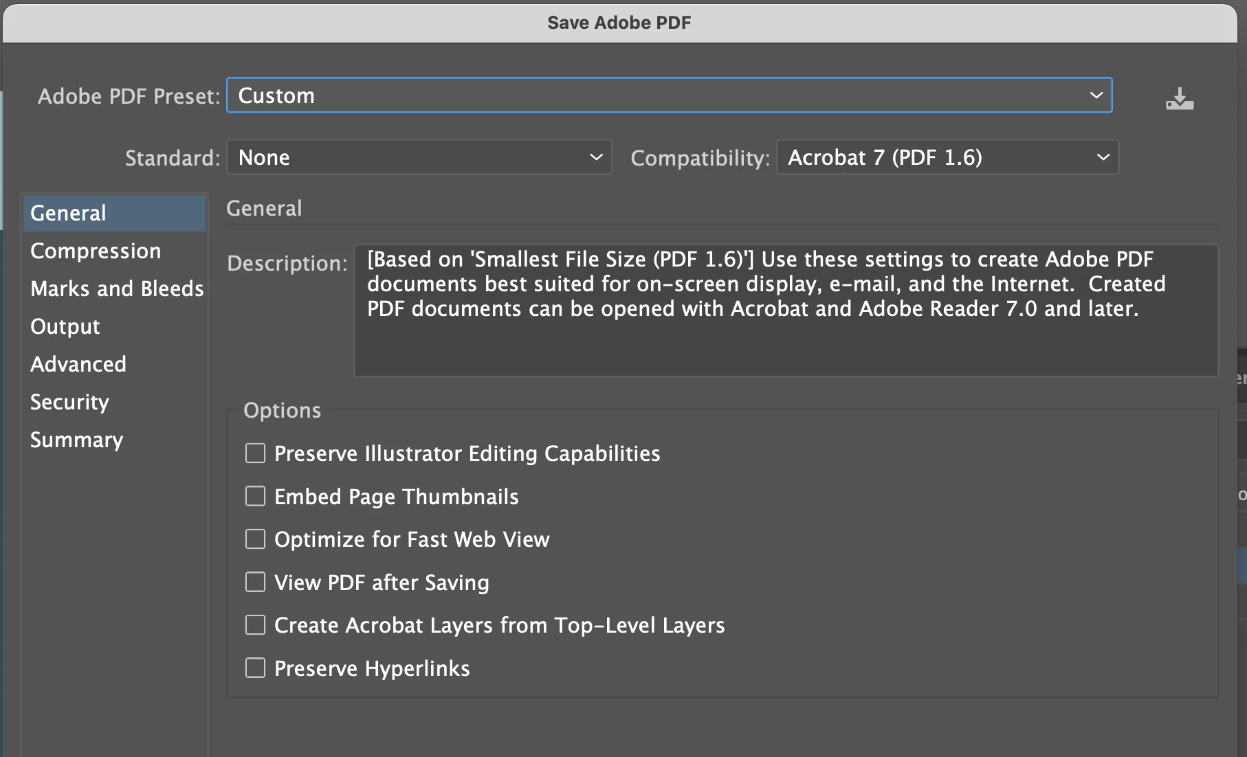

My solution: I opened the doc back up in AI, got rid of any layers (hidden or not) that I was no longer using*, and then when I saved the file as a PDF. When the Save Adobe PDF window popped up, I made sure that that  ALL of the checkboxes in the General tab were unchecked. This worked a charm!
*I’m not sure that I really needed to delete all of those hidden layers, but I’m glad I did!
Uncheck ALL the boxes here.
