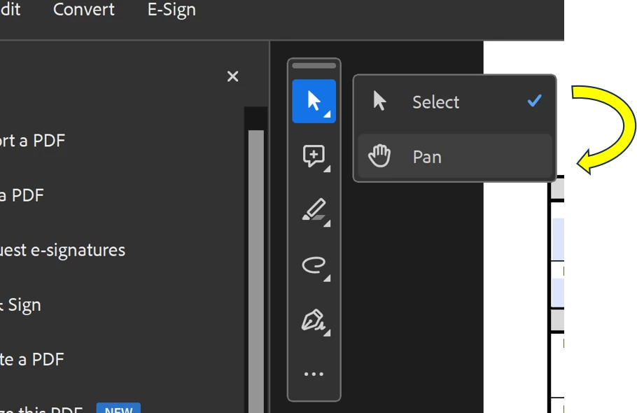

rubenm2021
April 20, 2024
Oh boy. Easy fix. Switch from the pointing/selecting arrow to the pan or hand icon.  See attachment.
April 21, 2024
Perfect, that works.

Bp82
April 19, 2024
Thank goodness it isn't just me! Appreciate the work around others found of using the Pan/Hand tool to select the text. I was about to go nuclear on Adobe.
Adobe... fix yo self!
April 19, 2024
Thank you for the fix this was killing me at work. I use spacebar for the pan tool so just to add, you may need to click on the arrow tool and hold it and the pan icon will appear. Thanks again!!!

April 18, 2024
Hello All,
A few of our users have been experiencing this issue as well. I imagine it is part of the most recent Adobe Update. The quick fix we found was changing the Select Text > Pan instead of Select. Hopefully Adobe will roll out a fix soon.
April 19, 2024
Thanks!  I am also having this highly annoying issue and the only thing that worked for me is this solution of selecting the  "Pan (hand)" icon instead of the "Select Text (pointer)" icon.  Adobe please fix this!!
