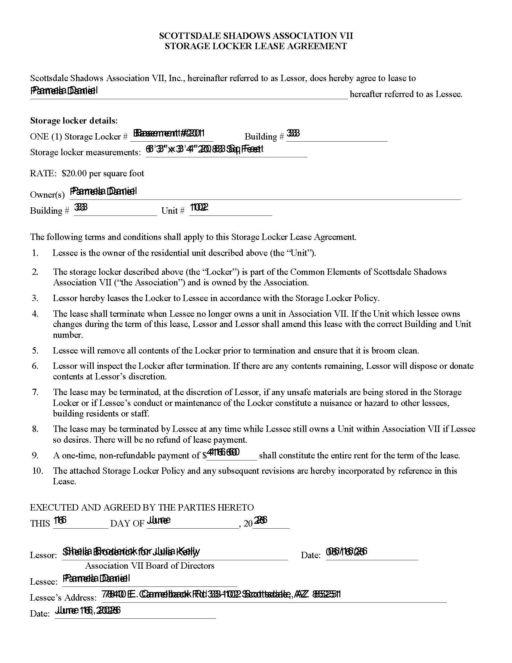

I have Adobe Acrobat Pro 2017.  I used word to create a document then made it into a PDF.  Then made it fillable form with no problem.  I filled out some information for a client, emailed it to her and she dated the document.  Once it was returned to me everything I typed and the date the client entered appears doubled. Can you help

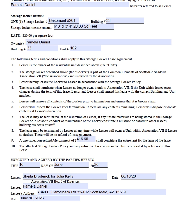

I’m using the latest update of Acrobat Pro DC (2026.001.21662) on a Mac tonight to view your PDF files. I’ve attached  the screen capture I made after opening your finished PDF form file. No duplicate entries.

Thank you Randy.  My client said she has a IPhone and it allowed her to highlight the areas and sign the form.  Not a true signature just type her name.  I do not use an IPhone so I am not familiar with this.  When I open the form and fill it out it is fine, no double-entries.  I actually did fill out some areas before sending to client, then sent to her but when I got it back everything was double-entries, the stuff I filled out and the stuff she filled out.   What I have been doing as a workaround is once I get the document back I open with Google Chrome and it looks fine, I print and save as a PDF.  I would not like to do this extra step if at all possible.

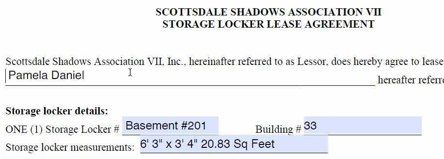

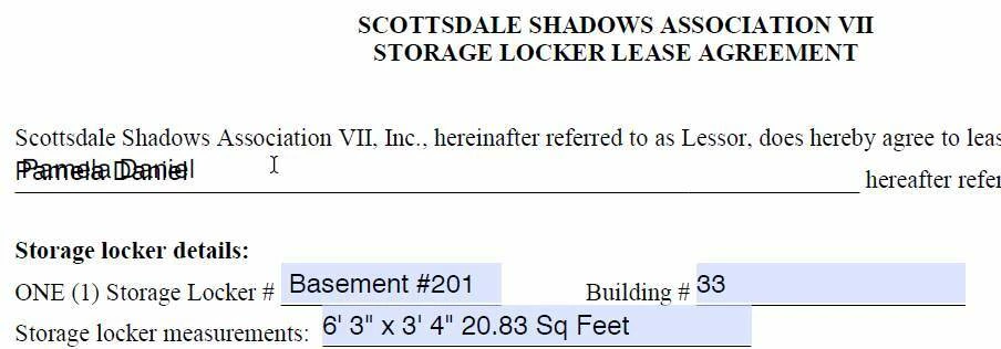

When I mouse click in the first field I get this:
After deleting the text in the field I see this:
May be that the form was not filled with Acrobat Reader or Adobe Acrobat.

All those areas are areas I fill out before sending to click.  I find it strange that the first field is doubled.
Bernd Alheit
Jun 18, 2026 4:14 PM UTC
The fields are not doubled.

When I opened the document, I didn’t see what you were describing. Each field had one entry, and each entry seemed relevant to the space allotted for it.
The PDF sample you provided appears to be a filled form. How does the original, not filled out PDF form you sent out look? You may have duplication of some form fields, but I can’t see that from the finished PDF form you supplied us. You may want to open the original, pre-filled PDF form, get your PDF editing toolset and see if you’ve got more form fields in the original than you think.

I find that very strange that you were seeing something different than I.  I created a jpg so you could see it.
You are correct the PDF that I attached was form filed.  I did look at the original, and I also attached it.  There are no duplication of field that I can see.  I will check out the two links you sent.  It is so strange because I have been doing it the same way for years and not sure what changed.  Thank you
