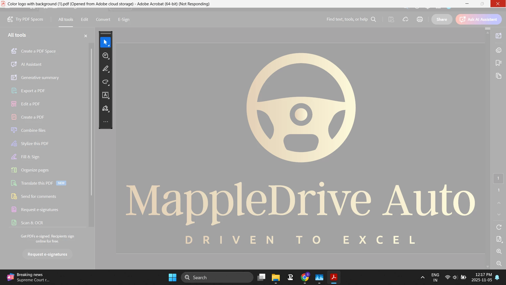

I see this is an old post and so I am here to raise the same issue but I am seeing this issue even after reinstalling from scratch.
