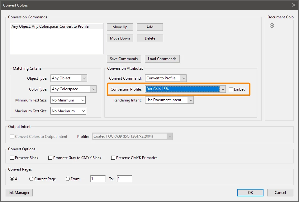

A grayscale file is printed on the K plate in any case.
"that is: converting the grayscales to the required CMYK profile with "Preserve Black", "Promote Gray to CMYK Black" and "Preserve CMYK Primaries" checked?"
There is no "Black", no "Gray" and no "CMYK primaries" in a RGB file, so it does not matter.
You have to use Acrobat's Color Converter and select a grayscale profile, here we mostly use the "Dot Gain 15%" for printing but ideally you should use the profile requested by the printer.
