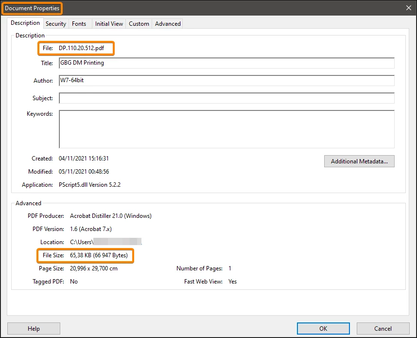

I notice the attached pdf is almost empty but very large. It was made starting from a CAD software.
How can I investigate this issue?
The property tab is quite silent

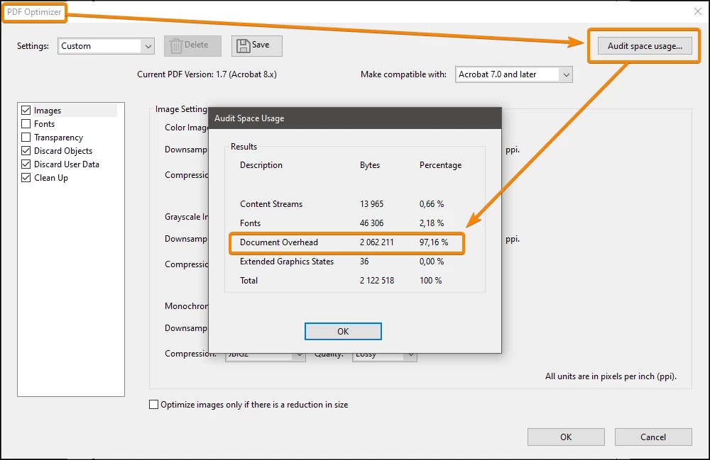

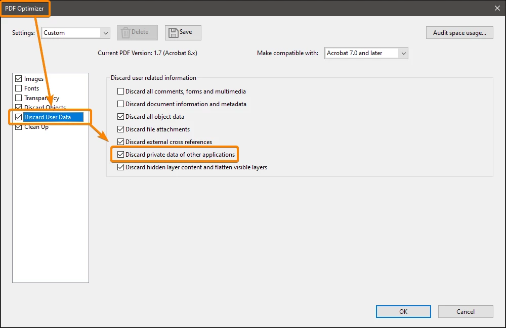

JR Boulay
November 4, 2021
Go to File menu : Save As Other : PDF Optimizer.
