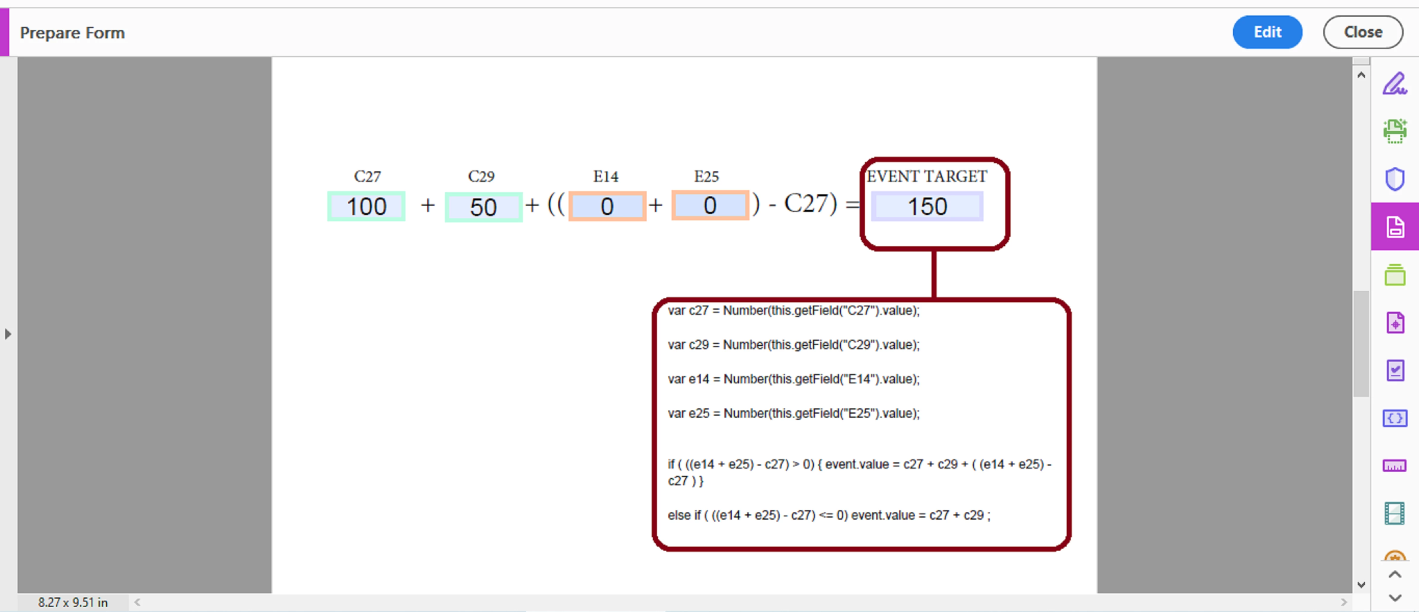

++ Adding to Try67's guidance,

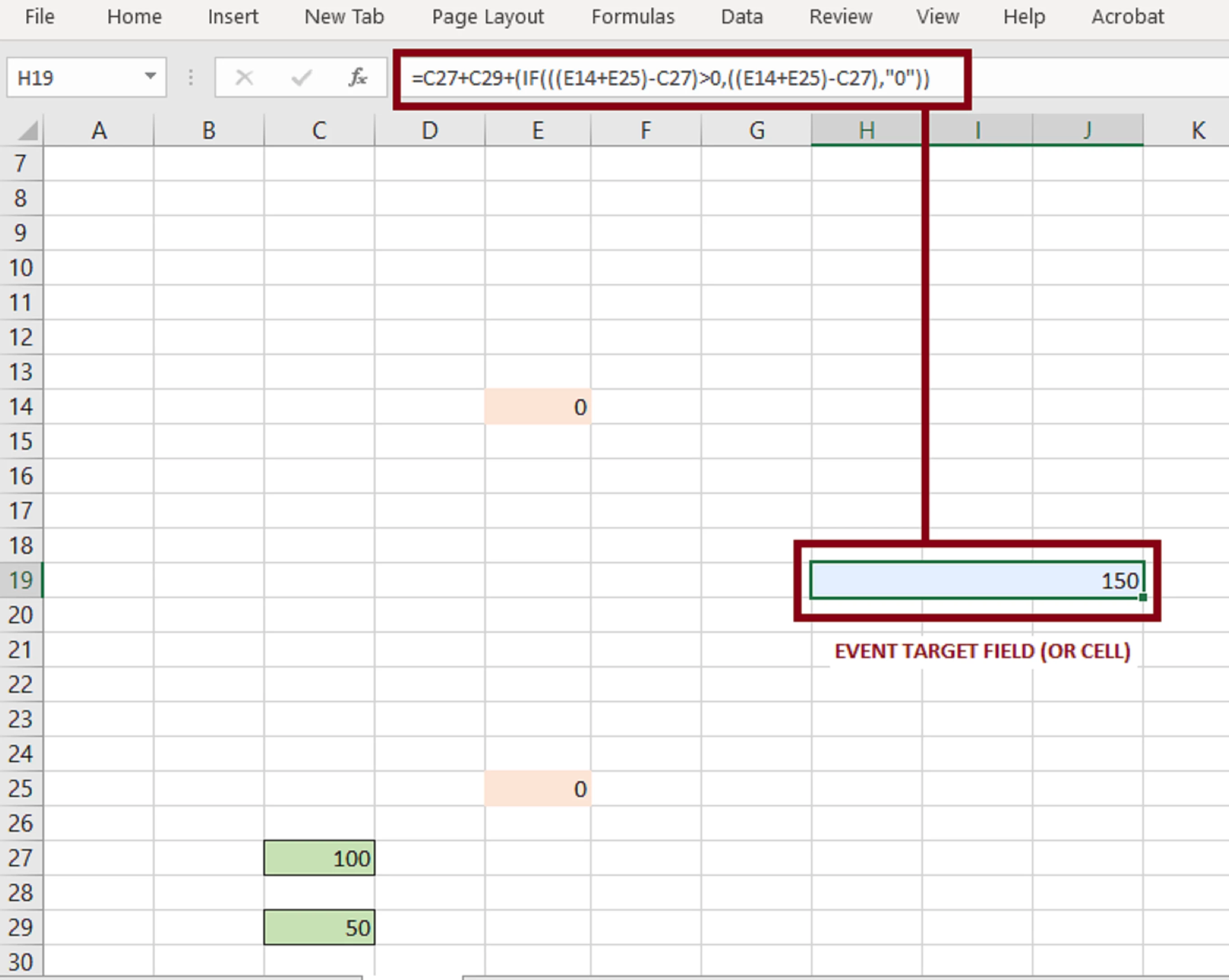

FROM THE EXCEL FORMULA: =+C27+C29+(IF(((E14+E25)-C27)>0,((E14+E25)-C27),"0"))
The total value of this formula is based on the SUM for this calculation: C27+C29+((E14+E25)-C27) as long as it meets the criteria for two conditions. And since the formula do have a nested "IF" function that tests for two conditions, you must consider how to phrase this properly with an Acrobat JavaScript.script.
If the first condition "((E14+E25)-C27)>0" is greater than the value of "0",  then the total value for this equation is true and "C27+C29+((E14+E25)-C27)" would become the desired total value.
Else, if the second test for that same condition above "((E14+E25)-C27),"0")"  equals "0", then the test for first condition fails and therefore and instructs the formula to return a total value for  "C27+C29" in the target field (or the cell that contains the formula in the case of MS Excel where this opration is performed).
If we want to express the equivalent syntax of a  MS Excel VBA Macro script with Acrobat JavaScript, refer to my example below.
In this example, instead of using different text fieldnames I will declare all of my variables with the same cell names that you were using in the MS Excel invoice that your boss gave you. This will make it all easier to follow.
/* IN ACROBAT JAVASCRIPT YOU NEED TO DECLARE YOUR VARIABLES FIRST.
IN THIS CASE, GET THE FIELD VALUES AND ESTABLISH THE DESIRED MATHEMATICAL FORMULA */
//Get all of the field NUMBER values that will be used in the equation NOT TEXT STRINGS
var c27 = Number(this.getField("C27").value);
var c29 = Number(this.getField("C29").value);
var e14 = Number(this.getField("E14").value);
var e25 = Number(this.getField("E25").value);
Now express an IF/ELSE IF condition with a custom calculation script to evaluate the totals of both conditions which will result in the total value that will display in the event target field
if ( ((e14 + e25) - c27) > 0) { event.value = c27 + c29 + ( (e14 + e25) - c27 ) }
else if ( ((e14 + e25) - c27) <= 0) event.value = c27 + c29 ;
  • Compare the script used above with slide below that contains the original MS Excel VBA Macro:
  •  And below, notice the total value which is the same result from the MS Excel spreadsheet using Acrobat JavaScript in my PDF document:

January 11, 2021
Thank you so much.  That worked out perfectly.
