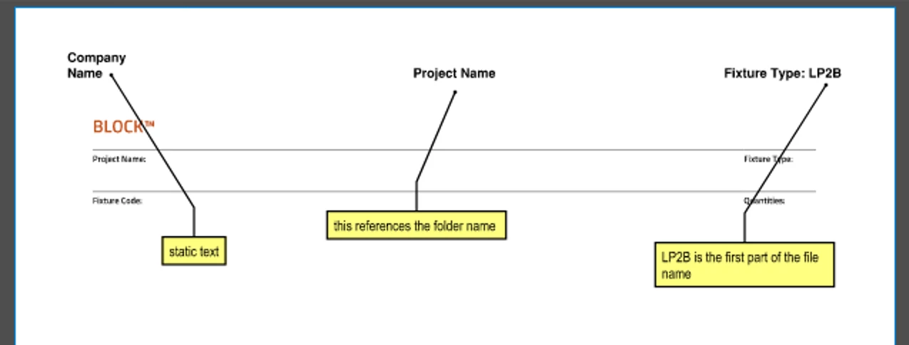

Hi I am trying to figure out a way to help automate a header process. Below is my header that I want to create. As you can see, the center and part of the right column I want to make dynamic to reference the folder name and the first part of the file name. New to this- from what i have researched this seems possible using a set of guided actions that incorporates javascripts.

3. Add custom header as shown below

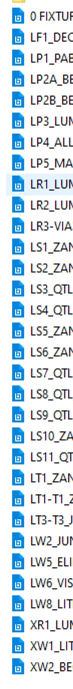

All my file names have a "_" after the fixture type which should help when creating a script to retrieve the partial file names.

Create a form field, or fields (left is left justified, center is center justified, right is right justified.  To the the folder name:
this.path.split("/")[this.path.split("/").length-2];
To get the file name:  this.documentFileName
To flatten:  this.flattenPages();
