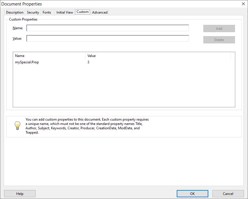

Hello dera friends,
in the published post `Get and Set PDF metadata from Acrobat JavaScript` by Mr. Thom Parker (https://acrobatusers.com/tutorials/get-and-set-pdf-metadata-from-acrobat-javascript/) is code for changing `Custom properties` in Acrobat. The JS code is: this.info.mySpecialProp = 3; // Create a custom entry
I'm wondering how to add a DOT in the code above? Namely, if I want to use a code with a dot like `this.info.mySpecial.Prop = 3; (where DOT is present in custom name aka mySpecial.Prop)` this JS code does not work with the ActionWizard function. Can someone help me to solve the problem? Thanks in advance for your reply and any suggestion.
BR Aljoša
Correct answer try67
As with most JS properties, you can do it if you access the property name as a string, instead of a variable name.
So use this instead:
this.info["mySpecial.Prop"] = 3;
The result:
You'll also need to access it the same way later on, though.

try67Community ExpertCorrect answer
October 10, 2022
The result:
