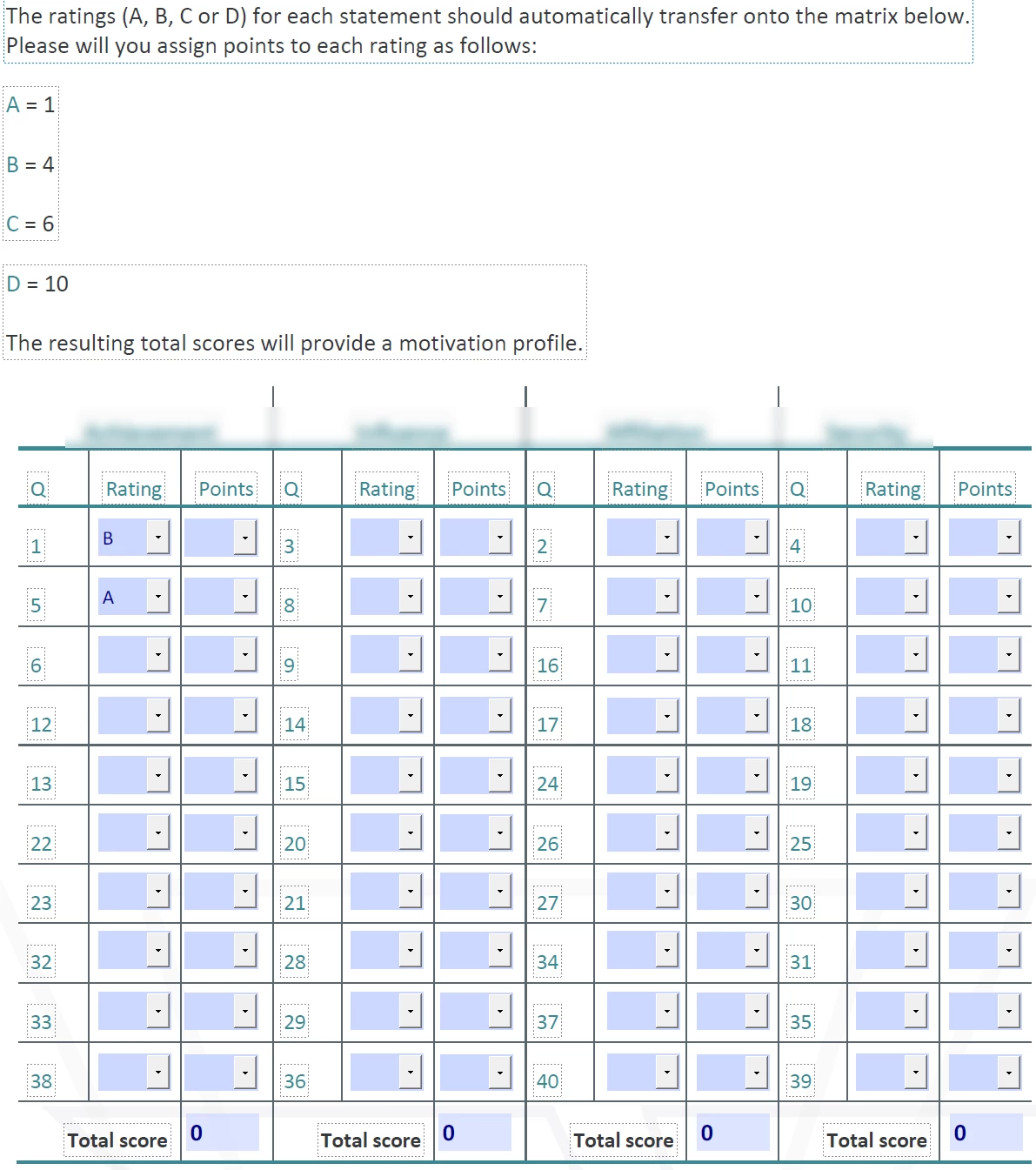

I require help in incorporating a formula/calculation script into an Adobe PDF form. The aim is to have a dropdown box that, when selected, automatically adds the correct number of points in the adjacent box.
For example, if option A is selected, the adjacent box should display 1 point. If option B is selected, and option C is selected, the adjacent box should display 6 points. Similarly, if option B is selected, and option D is selected, the adjacent box should display 10 points.
In summary:
A = 1
B = 4
C = 6
D = 10
Although this may seem like a simple task, I have not been able to find a straightforward solution during my searches. I've attached a screenshot which may explain it better!
Thank you in advance!
Correct answer Bernd Alheit
Use 1, 4, 6, and 10 as export values for the dropdown entries.
Bernd Alheit
Bernd AlheitCommunity ExpertCorrect answer
February 8, 2024
MT-*kAuthor
February 8, 2024
Amazing Bernd, so simple yet without this wouldn't have got it, thank you so much!
