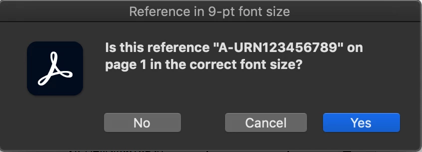

As the script can't directly check the font size, a dialog box will ask you to confirm firstly the correct size of a reference before checking all other ones.

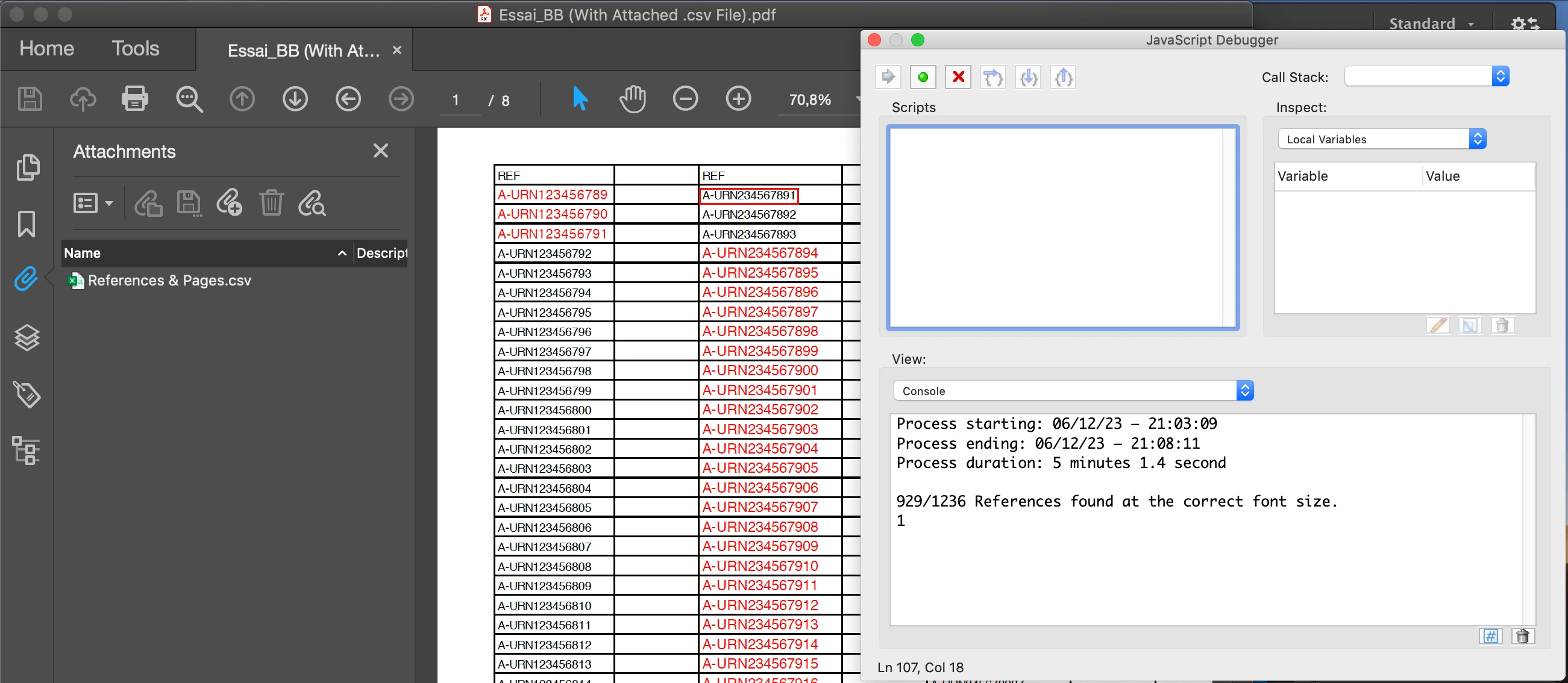

Once the process completed you will get an attachment in a copy of your ogiginal file.
The reference surrounded in red is the one use for the font size.
Attached is the result of the example file I used to generate the script, and here is the script:

				var question=app.alert({
					cMsg: "Is this reference \""+theReference+"\" on page "+(p+1)+" in the correct font size?",
					cTitle: "Reference in 9-pt font size",
					nIcon: 2,
					nType: 3

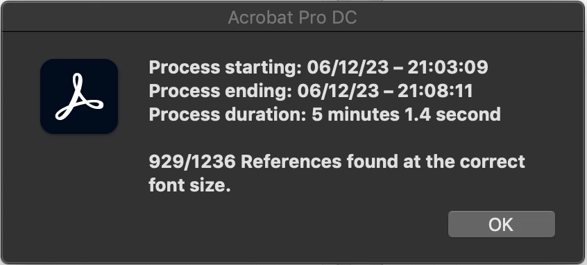

var txt="Process starting: "+starting+"\rProcess ending: "+ending+"\rProcess duration: "+theTime+"\r\r";
if (found) {
	this.createDataObject("References & Pages.csv", "");
	var oFile=util.streamFromString(references);
	this.setDataObjectContents("References & Pages.csv", oFile);
	this.saveAs(this.path.replace(/.pdf$/i," \(With Attached .csv File\).pdf"));
	this.viewState={overViewMode:7};
	var plurial=found>1?"s":"";
	txt+=found+"/"+nbRef+" Reference"+plurial+" found at the correct font size.";
} else txt+="No reference found.";
console.clear();
console.println(txt);
app.alert(txt,3);
