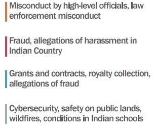

Yes, we have tried it in all different browsers, different machines, all different monitors, tablets, mobile devices, etc. I also made sure to try magnifications from 25% to 350% and it is consistently showing up. Also tried saving, closing reopening, restarting the machine, etc. several times. It unfortunately isn't a screen issue, it's definitely showing up in the file. Here is just a small snippet of one section where it is showing up:

Can see in your samples that it's lowercase i, uppercase I, and lowercase l.
Did you embed the fonts into your PDF when you exported it from InDesign?
Did you try to embed the fonts into the PDF before you did the accessibility tasks?
