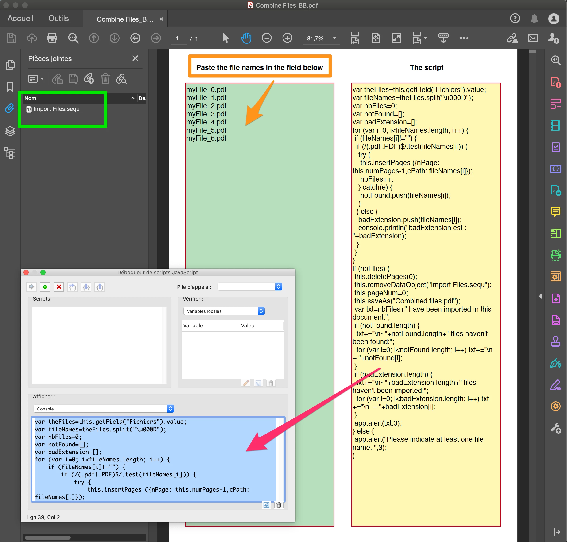

All your files must be in the same directory.
Place the "Combine Files_BB.pdf" attached file in this directory then open it.
You paste the list of files in the left field then 2 solutions:
Either you copy the script of the right field then paste it in the console (then select all and "Enter") or you import the action wizard included in this file then run it.
You will get a combined file including all (correct) files indicated. If it's possible, sort the files before run the script because the files are imported in the indicated order.
Let me know if that suits you.

As indicated, it is not possible to read the content of a folder, but if all your files are in a same forder, you can copy then paste all the file names in a text field then use it to recover the names.
With macOS it very easy to do that, but I beleive it's a bit more complicated with a Windows OS.
I already did that, so let me know if you are interested with this solution and I'll send you an example file.
