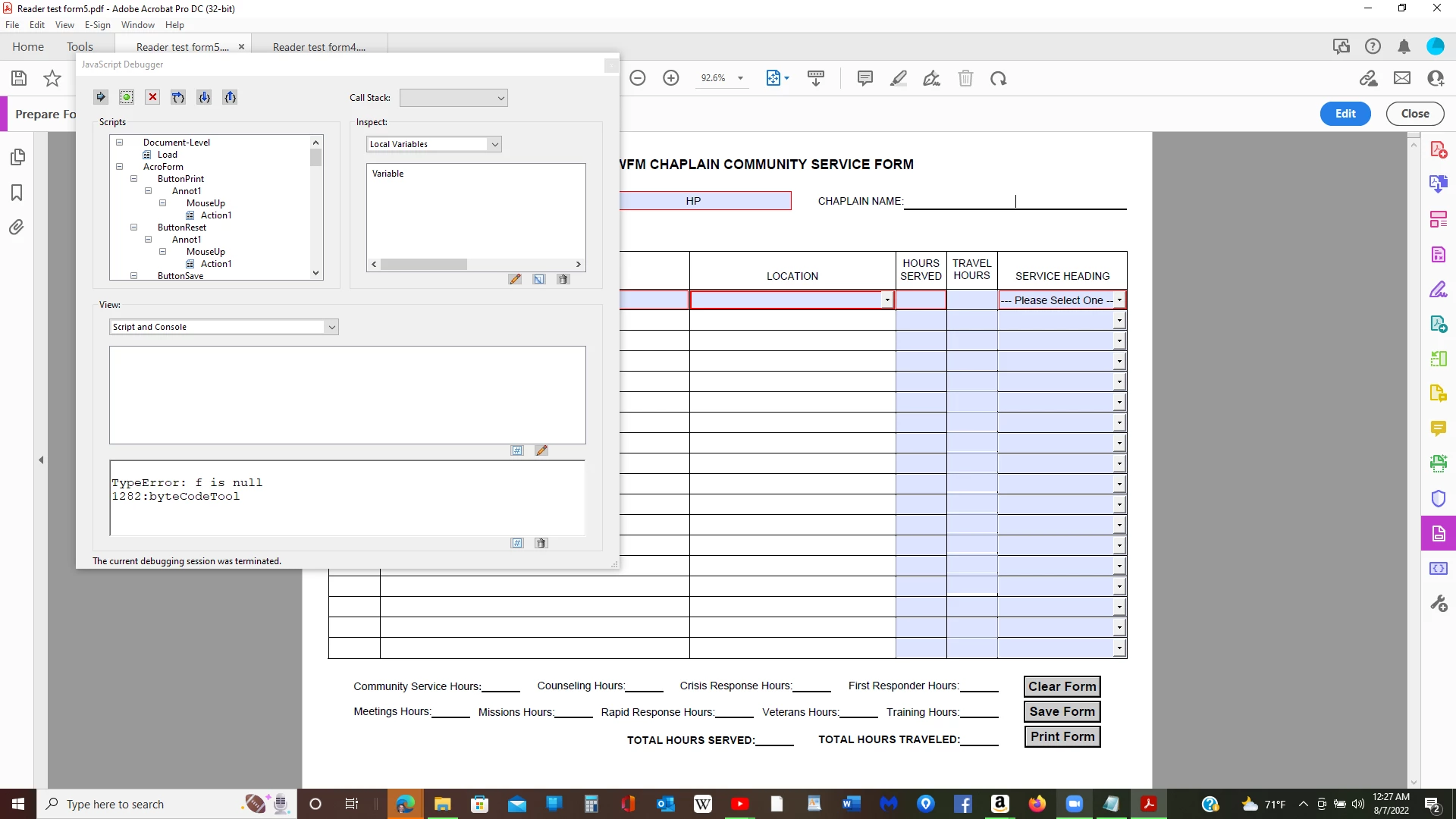

Cann somebody help me locate and fix this error?

Here is the whole list of errors after uninstalling Acrobat Pro DC 32-bit and installing 64-bit. I even tried doing a repair on the new install which is latest version:
Exception in line 1282 of function AFSimple_Calculate, script byteCodeTool
Exception in line 1 of function top_level, script Field:Calculate
TypeError: f is null
1282:byteCodeToolException in line 1282 of function AFSimple_Calculate, script byteCodeTool
1282:byteCodeTool

August 7, 2022
I thought the reset button was causing the issue, after I changed some of the code, but when I went back to original code

, still getting the error and also f is null error:
