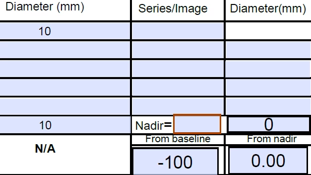

Example below:
the 10= FIELD1
Field 2: Diameter (mm) value = 0 because nothing is entered in the rows above - see all NULLS
Field 3: From BASELINE = -100 because its' calculating percent change from (0-10/10)  *100 = -100. I need the 0 only to be calculated if that sum really is 0 vs null as it is now

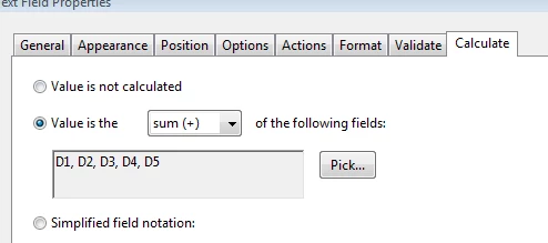

Field1: diameter baseline sum : sum function in the text field properties

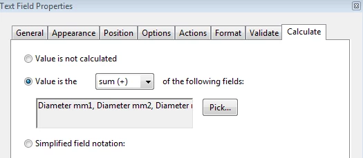

Diameter 2 --- sum function in text field  ( where the sum default is 0)
