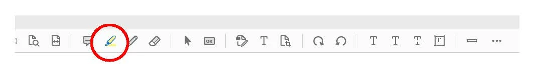

Herramienta "Resaltar texto" no funciona
Alguien sabe por qué no me funciona la herramienta "resaltar texto"?
El problema está en que activo la herramienta, selecciono el texto que quiero resaltar, pero no queda resaltado.
Se trata de la versión Adobe Acrobat DC.
Gracias

August 25, 2020
Hey Miquel,
When you say Highlight tool doesn't work, does this mean the highlighting tool doesn't select or the highlight color doesn't appear?
Could try a few things to work on-
1- Check with a different document. Make sure it has the real text to select not a scanned file.
2- If it doesn't help. Then restart your computer, reopen the application and check back. At times a simple restart solves many issues.
3- Make sure that you have the latest patch installed: https://www.adobe.com/devnet-docs/acrobatetk/tools/ReleaseNotesDC/index.html
Let us know the status.
Akanchha
