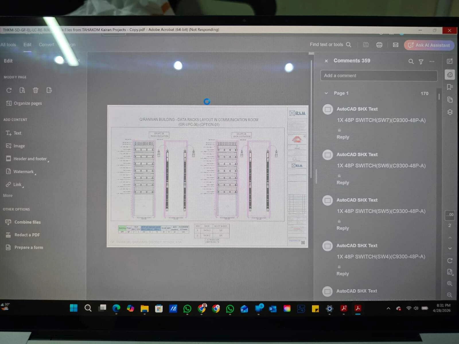

Hi Dear Supporter, i am using Adobe Acrobat Pro, i am trying to edit some files always getting stuck my software, can you pls help me to solve this issue

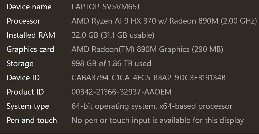

    NAZEET TKP
    Apr 28, 2026 5:33 PM UTC
    Dear Supporter
    I am using ASUS ZENBOOK S16
    I need to Edit Some Text and delete Some Drawing picture from Autocad Export PDF File, or any Larg Files, its taking long time and not responding Adobe Acrobat 64 (Purchased ACC)
