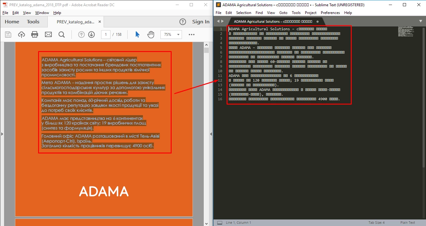

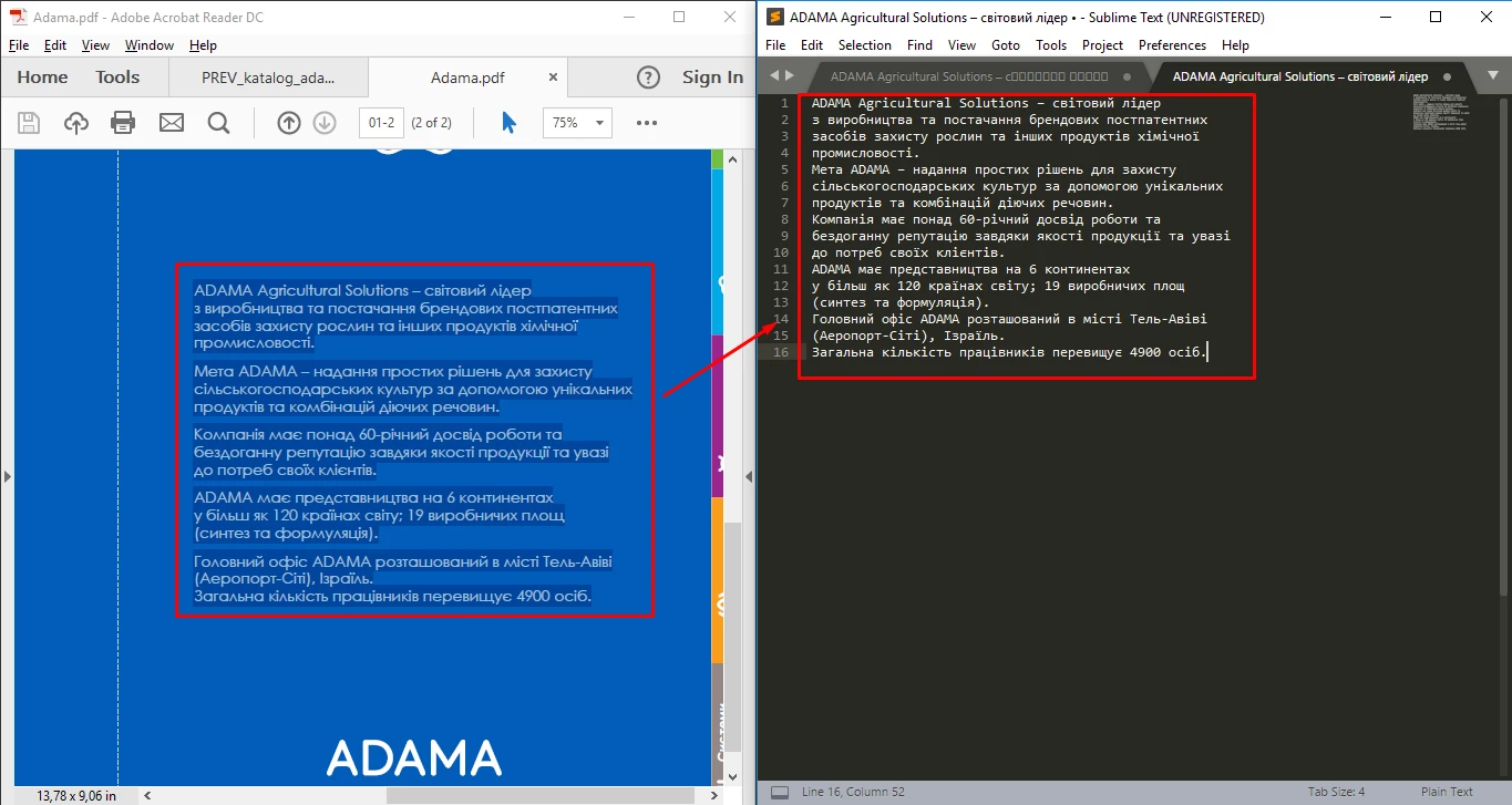

Hieroglyphs when copy from .pdf file to another file
Both files are attached. I think it is connected with fonts. Maybe someone has ideas how can it fix? Thanks!

This is related to fonts, but there is not much you can do. When the PDF file was generated, the application that generated it did not provide a table that maps the "drawings of characters" (or glyphs) back to the the character(s) they represent. One potential workaround is to export the document as image files, and then import these images back into Acrobat, and then as a final step run OCR on this newly created file. You should now get better results as before.
