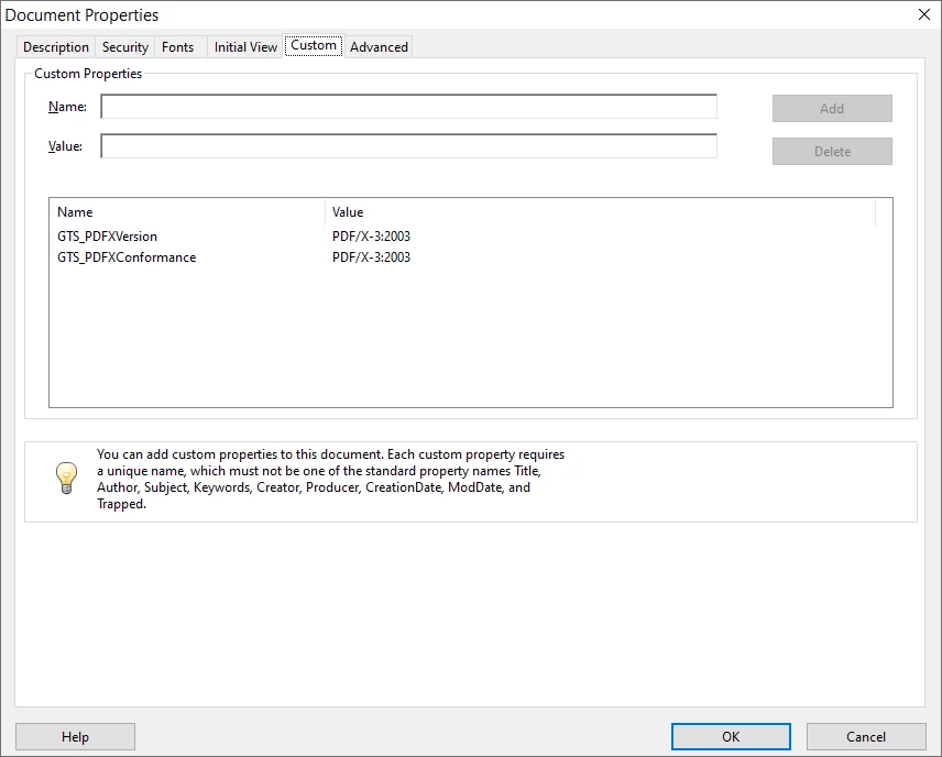

Correct answer try67
a sample pdf document x-3:2002 was recorded ...
How can I see that this is recorded as x-3:2002
Go to File - Properties and look under the Custom tab:

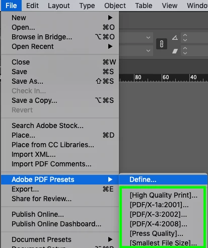

You can't know the exact presets that were used, as they are mostly parameters to create the document. You need to guess, from some indications in the PDF file, what presets could have been used. The presets are modifiable, and I used to create presets for our needs, based on existing presets. If you analysed the documents created with those presets, you would basically conclude that we used the PDF/X-4:2008, even if that was not necessarily true.

What kind of "presets", exactly?
idjev
idjevAuthor
February 26, 2024
Created pdf documents are saved by selecting these presets.

PDF/X is a specific type of PDF files, and that you can find out, but I don't believe the other information is stored when the PDF is generated.
