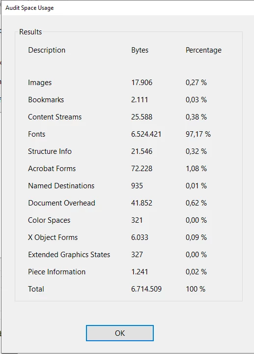

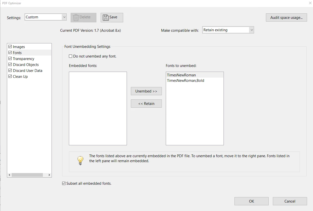

    Update: I was able to inspect the PDF in question.
    Embedded fonts were the main culprit causing the oversized document. For some reason, the fonts did not show up as un-embeddable under the Optimize PDF settings--however, they were listed under the Document Properties>Fonts. I suspect some form of corruption in the original program.
    As mentioned before, “refrying” the PDF reduced the file size but when replacing the original pages, the form fields did not line up correctly. While this could be fixed by adjust the position of the fields per page, the document grew again upon saving.
    I ended up using callas pdftoolbox to unembed all fonts. The Times New Roman changed to Minion Pro, which I believe is included in the newer versions of Acrobat. The file size, with form fields, ended up as 161K.  (I inspected a couple of pages of the form but left the other pages for the OP to inspect.)
    Abhayy_4566
    Feb 18, 2026 12:32 PM UTC
    I think the reason is your entire font file is fully embedded.
    open pdf File - save as other - optimized PDF
    Now go to fonts tab now see subset embedded fonts when percent of characters used is less than, set this to 100%

    MalokMalok
    Feb 12, 2026 10:47 AM UTC
    Hi Dave, thank you for your reply.
    After checking the Audit Space Usage, we noticed that fonts account for 97.17% of the file size.
    When we run the PDF optimization (keeping default settings and making sure not to select any form-related options), the file size is reduced by only about 1.5 MB, which is unfortunately not sufficient for our use case.
    Attached you will find screenshots of the current Audit Space Usage and the Advanced Optimization → Fonts section.
    If there is any recommended configuration or best practice to significantly reduce the space used by fonts, it would be extremely helpful.
