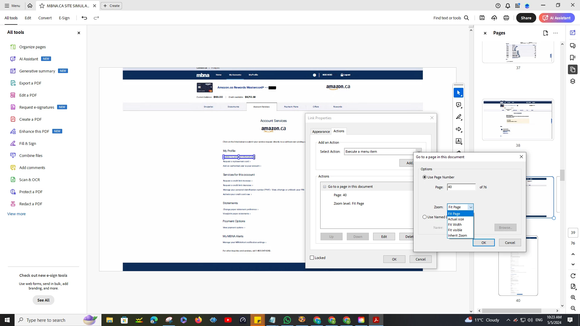

The issue I would be scrolling from page to page, and it would keep changing the zoom layout, no matter what I did. I could set it to view the actual size, and as soon as I'd click on any image to do anything with it, and I'd go back to one where I had to scroll quite a bit before it would go to the next slide, it would go back to doing the same thing. I noticed when creating a link you can change the layout to "Actual Size", but that doesn't do anything - any other link you create on the same page goes back to "Zoom: Custom", and I don't see what clicking a link on a page has anything to do with a particular zoom level. He looked at it, and agreed it seems like a glitch. Yes, I went to "Preferences -> Page Layout", and I changed it there, but it did diddly doo daaa.
It's another big time waster, but now I'm trying to figure out how to make sure the audience viewing this file that it shows as "Actual Size", but the only option I see it "Fit Page". I just want to avoid squishing ... since the actual images don't look squished, I'd think I'd be fine, no?
What is the point of when you highlighting a link choosing the "Zoom" and changing it to "Actual"?

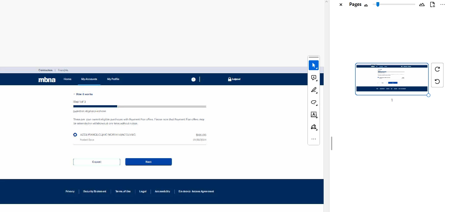

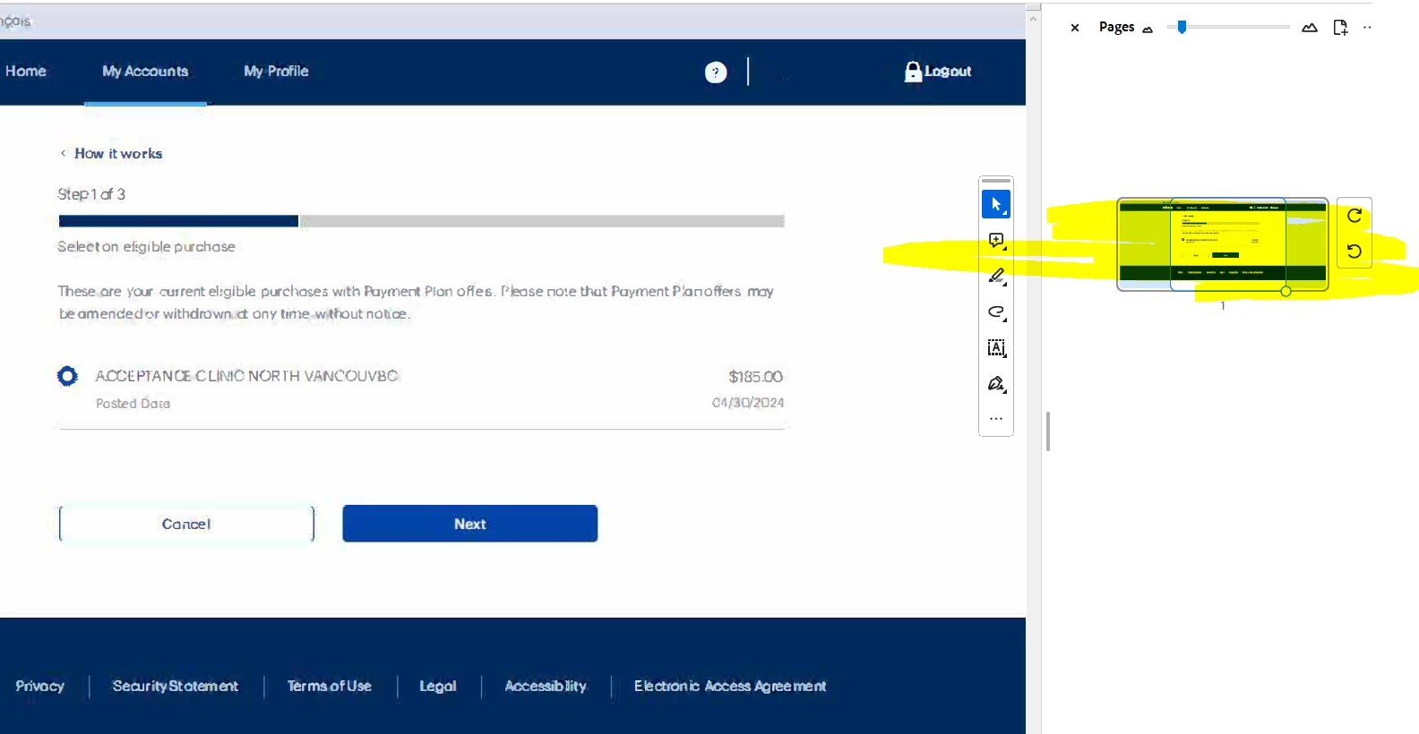

2 - When going from page to page, some of the time it will stop on the page and you can see in the preview page pane that there is like a bubble around part of the image as you are scrolling. If you expand that to cover the entire image (see screenshot), then when you get to that page again, when you scroll down once, you get the next page, and you don't have to scroll till you get to the bottom of the page and you don't have to keep pressing CTRL-0 as much to see the page better. Sure, you can select "Zoom to Page Level", and it will be fine for the moment. However, as soon as you select ANY OTHER image to do anything, as soon as you scroll down to the page you had just fixed, the scrolling thing happens again.
See TEST1 and TEST2 attachments... you will see the bubble I am talking about, when it is like that (Test1), the scrolling thing happens - if you manually expand the bubble, you get TEST2, so you get to the page, and one scroll down and you're onto the next page - but as I said, as soon as you go to ANY OTHER slide and do anything there and come back, it resets things.
