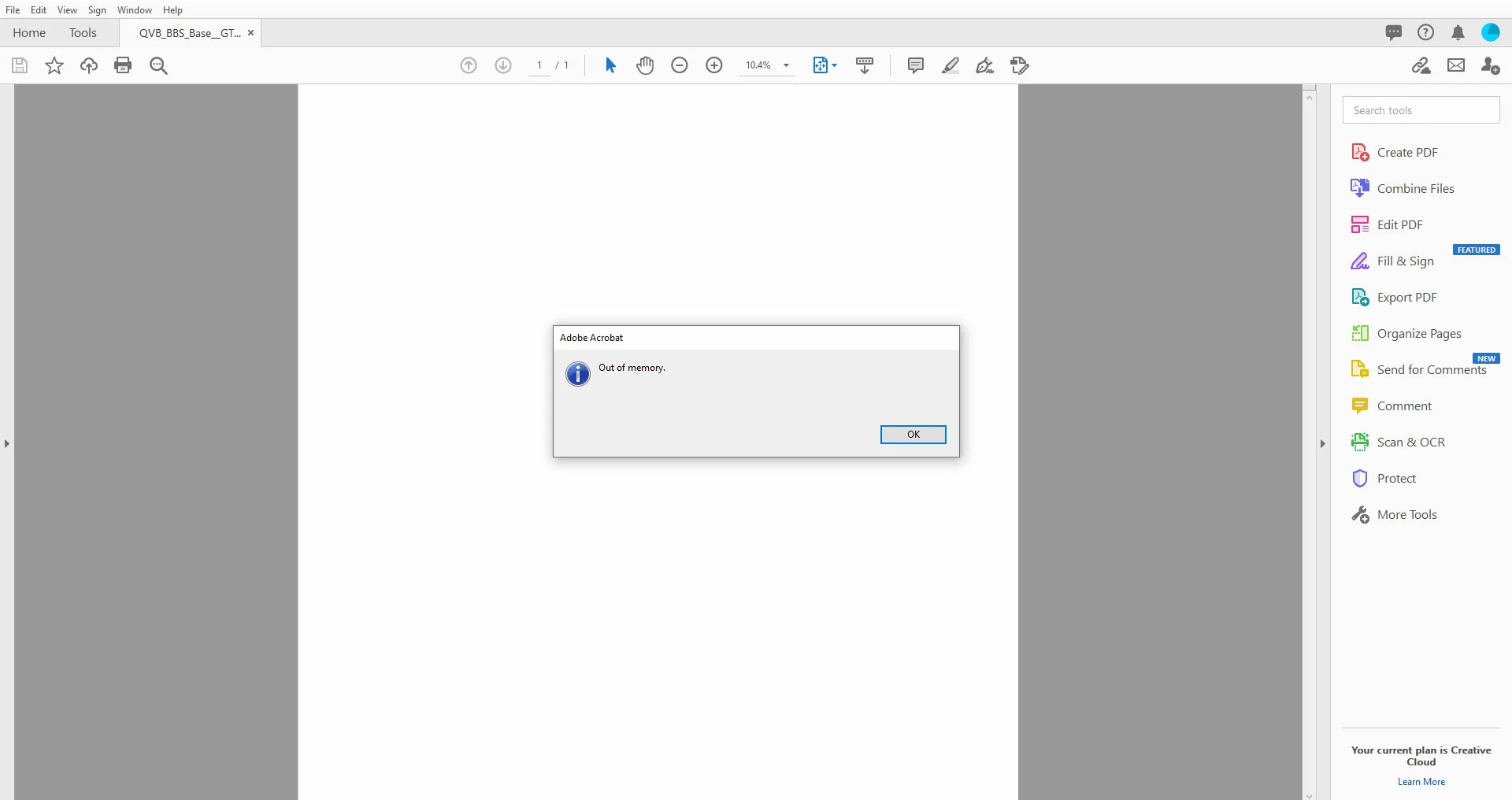

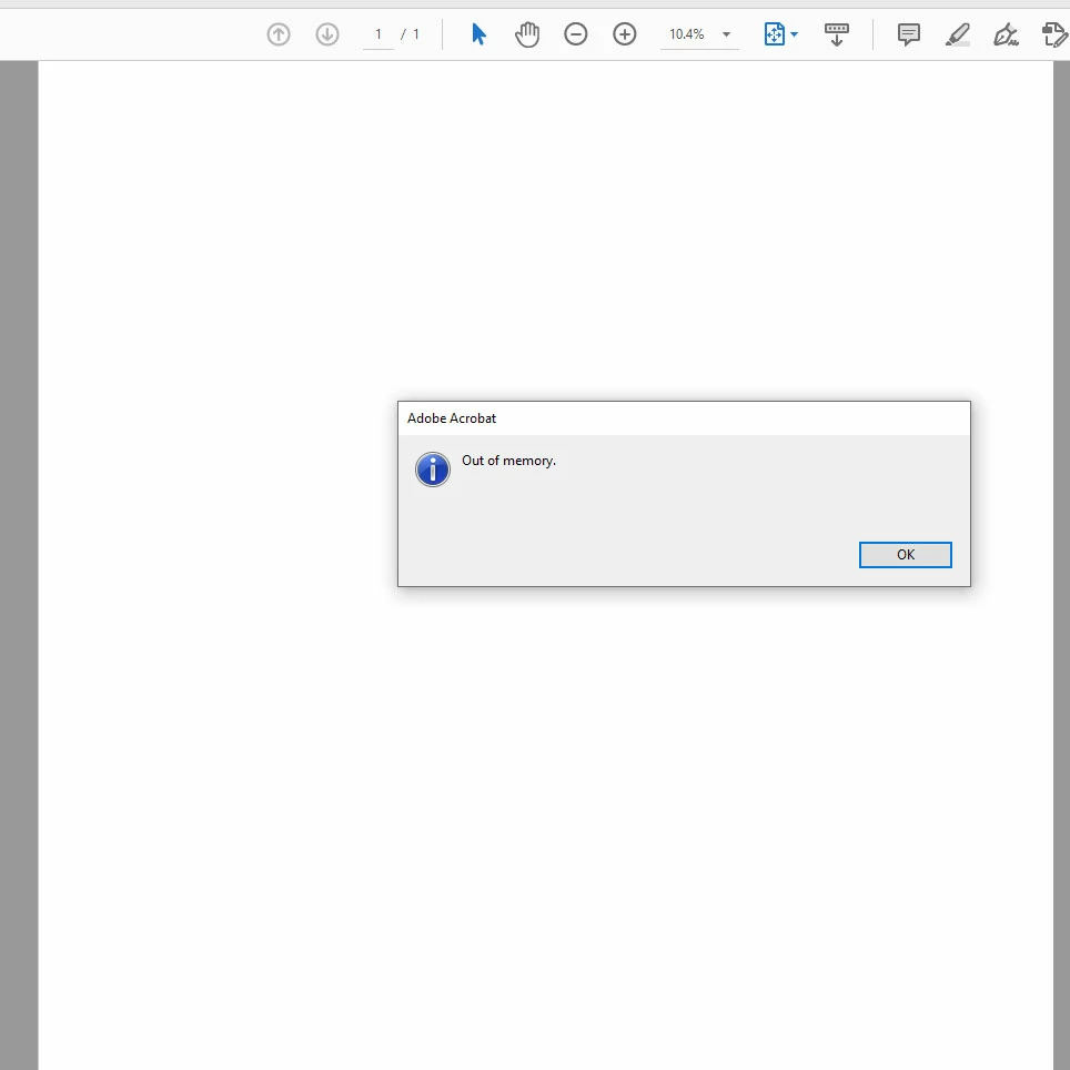

I sure can. Please find a screen shot attached. It normally pops up with the artwork displaying but instead, shows up white/blank like this and the 'Out of Memory' notice in the middle. Please find two shots below. Thank you for your efforts!
SOS... I have print jobs that are past deadline.
September 21, 2020
You actually cannot publicly share the pdf without closing the 'Out of memory' box first. Then it is just a blank pdf.
