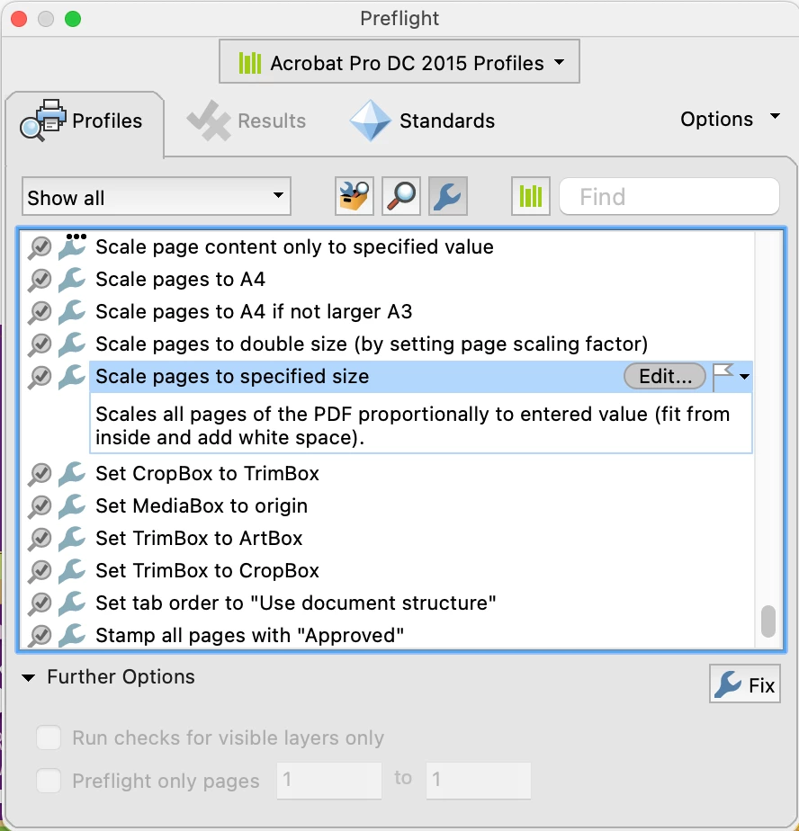

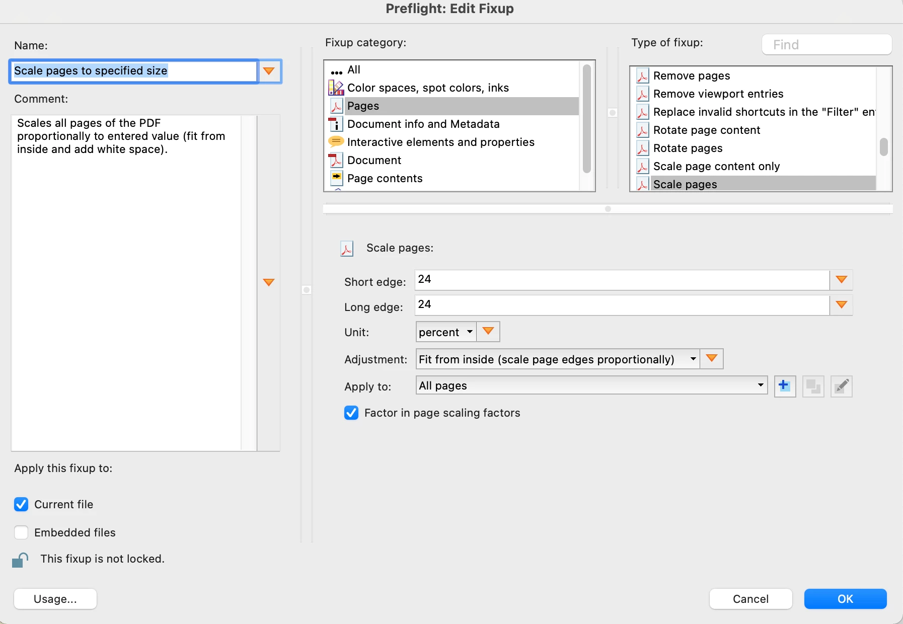

tc58150421 says:
I have been having this problem for the past couple years after updating my work computer's OS and Adobe software to CC. While it appears that the root of the problem has yet to be solved by Adobe, there is an easier temporary fix that does not require opening the PDF or JPG in another program. This solution is based off this article from the Adobe help forum "How to change the size of a PDF page using Acrobat DC Preflight tool on a Mac." https://helpx.adobe.com/acrobat/kb/Change-PDF-page-size-in-MAC.html
If all pages of your PDF are going to be the same size, you can simply follow their exact instructions.
If you have multiple page sizes in a single PDF, you can scale the pages by a percentage to reach your target page size. I don't know if this bug affects everyone's page size the same way, but on my computer scaling to 24% corrects the oversized pages.
So in the Scale Pages dialogue box, enter these values:
Short edge: 24
Long edge: 24
Unit: percent
Short edge: 24
Long edge: 24
Unit: percent
August 1, 2021
I get to step 6 in their guide and I don't even have the option to choose "Scale pages to specified size":
It's comically ironic how unhelpful their help section of their site is. Nothing is updated, even though every Adobe product is updated seemingly everday.
How can I access this "Scale Pages dialogue box"?
