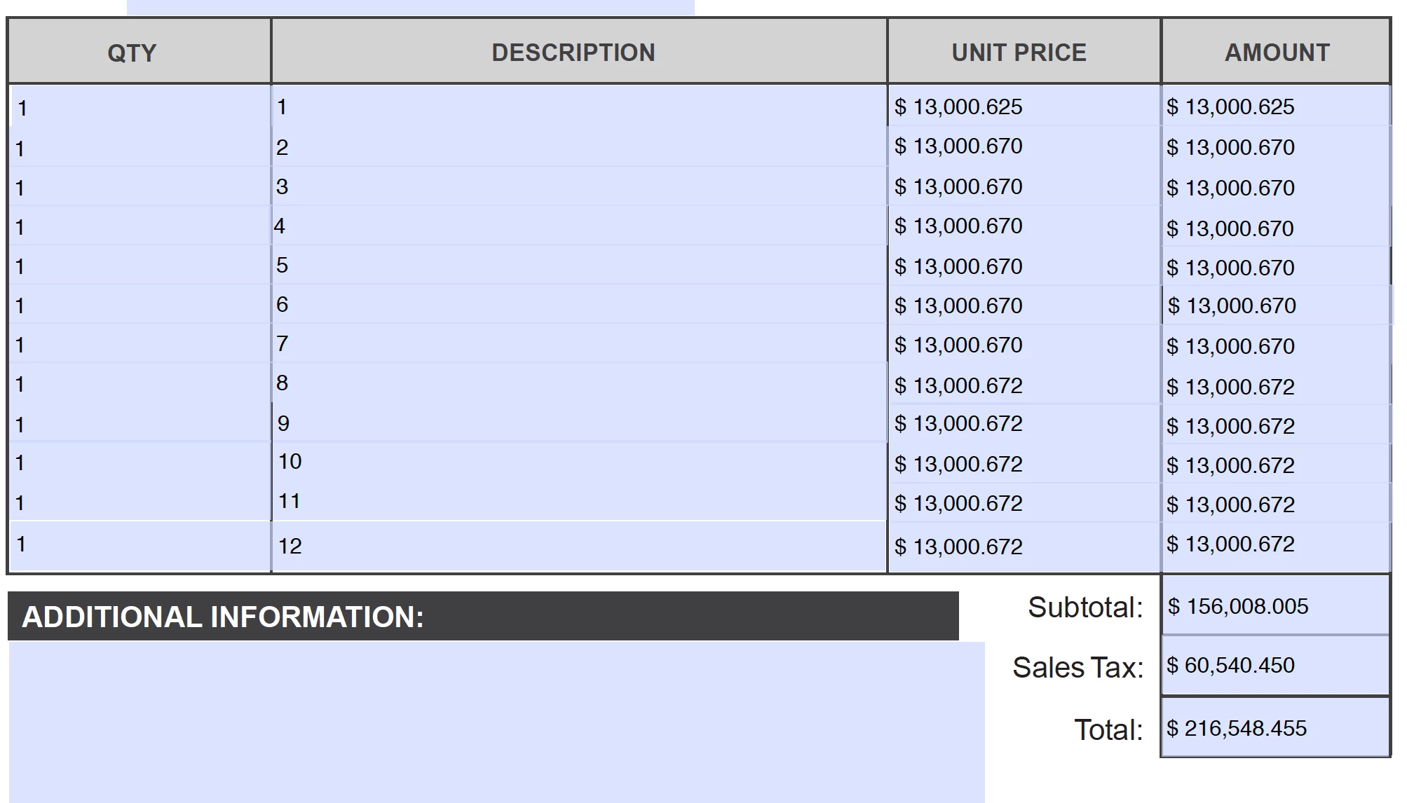

For example. There are occasions when I need the number to say $60,000.125. But another line might cost $12,000.670 But I want it to read $12,000.67 when the third place is zero. Any thoughts? Please help!
Thank you!

May 8, 2019
Is this a calculated value? If so, what code are you using for it?
May 8, 2019
This is what I have. I'm just using the regular formatting when creating a form. Qty x Unit price = Amount
Looking for when the third decimal is zero, to be hidden if possible. Does that make sense?
try67
May 8, 2019
You'll have to use a custom Format script to be able to do it.
