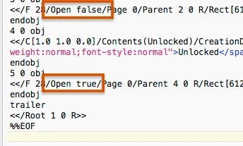

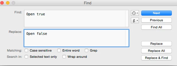

This is easy, but you'll need to edit the comments in your favorite text editor. I'm going to refer you to a related article I wrote: How to Globally Change Font Size of Text in a PDF Sticky Note.​ The end result is different, but that article is well illustrated and should provide a bit more insight.
For your task, you need to:
  1. Export all the comments to a data file.
  2. Change the extension of the data file from FDF to XML.
  3. Open the data XML file in your text editor.
  4. Do a search for " Open true" and change it to "Open false"
  5. Save the XML file.
  6. Change the extension back to FDF.
  7. Back in Acrobat, delete all the comments.
  8. Import the FDF file you just edited.
Now all the comments will be locked.
