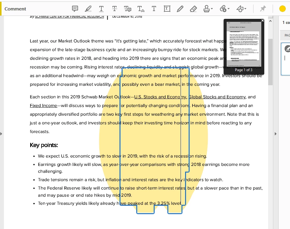

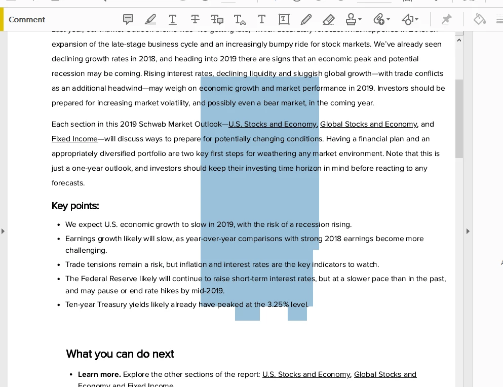

Well, the selection tool is *not* intuitive or working "right out of the box" - I am using the latest version of DC and my highlighting tool seems to be selecting a random block of text - and, by appearances, defaulting to a huge cursor (font size) setting. Once selected, I can't adjust the selection window to frame only the desired text. Wish it worked like it used to...simple, intuitive. Searched all Preferences and Settings - thought maybe it had to do with page or view scale. Can anyone help that does *not* work for Adobe? Thank you. attaching screen shots...

As mentioned above, that is usually the result of an incorrect OCR process.

It's also possible that the PDF file was generated with a low quality PDF generator, and that no OCR was involved at all. Unfortunately, there is no way to get this document to behave any better. You can however create a new document based on the current one by saving as a high resolution TIFF image (or a series of images), and then importing these TIFF images back into Acrobat. When you now run OCR, you should end up with a document that can be correctly highlighted. This is not straight forward, and will of course not bring over anything that is in the original document besides the actual pixels that would print (e.g. meta data, form fields, JavaScript, ...), but if the only objective is to have a document that can be highlighted, then it's certainly an option.
