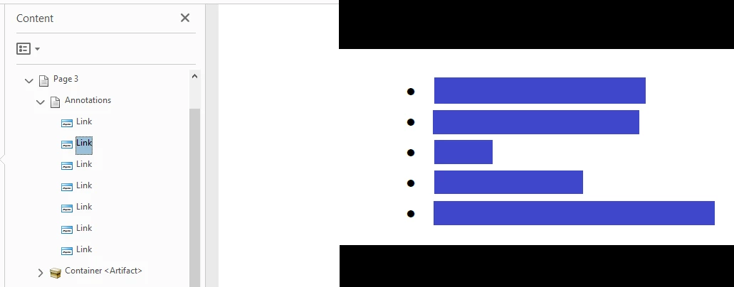

Under the Annotations under my Content panel, there is a link that does not highlight any content when selected. It has an associated link objr under the tags panel. I'd like to remove this from my document. It's possible to delete the link objr under the tags panel, but the associated link annotation remains. This leads to a flag under the accessibility checker. How can I delete this link annotation?

In this first image, the link--which is unfortunately not a weblink but an internal-facing link that directs to another page--creates a highlight as intended and the associated link annotation. I've redacted the text, but the regular text is in black and the linked text in violet:
In this second image, the second link annotation does not show a highlight. Without the highlighted box, I'm unable to choose to edit or delete the link and link annotation:
In this third image, the third link annotation is associated with a highlight over the second linked text.
Each of the link annotations are also associated with a link objr in the tags panel. What I'd like to do is delete the second link annotation that isn't associated with linked text in the document and that doesn't create a highlight.
If it helps, the original document was created in Word, which was converted to PDF.
JStroAuthor
December 14, 2021
Here's a second image of the second annotation highlighted, but not showing a highlight box around any linked content. The violet redaction boxes are the only links on that page in the document. There should only be five link annotations, but instead there are seven. I want to remove the two link annotations that do not create highlights.
