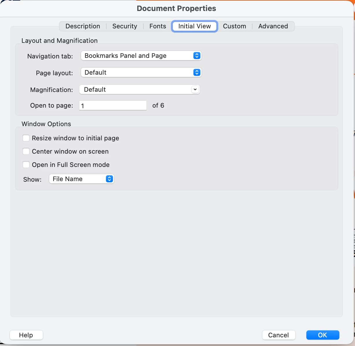

Hi @QCHOG,
Thanks for reaching out. If the file's author has set the initial view to launch the Bookmarks panel, the initial view preference will override other settings. The bookmark panel will always be visible whenever you open the file.
Check the screenshot of the file set to launch the Bookmarks panel by its author.
You can check the initial view settings under File Properties in Adobe Acrobat. It is not possible to see this setting with Adobe Reader.
