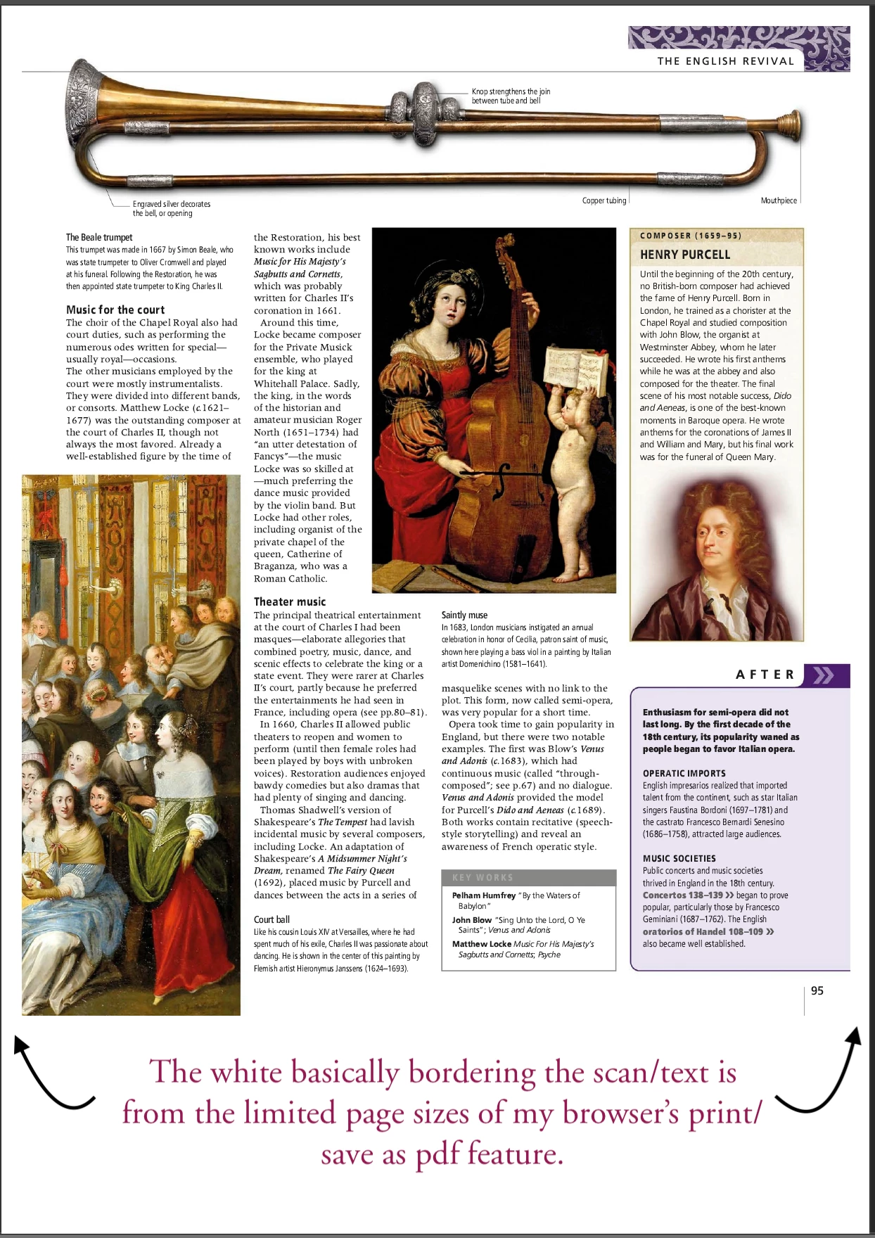

Basically I sorta have a good idea on what general cropping is like, even disabled the default "snap to grid" nonsense, however I cannot see myself acheiving much progress effeciently by needing to spend 2-3 minutes manually, and painstakingly cropping to the edges of a scan (which serves as the background image in question)-- and I can't even imagine the frustration I'd have then realizing that I may or may've not screwed up on consistency when it comes to said PDF size being wrong, or it being correct but cutting off the scans.
Is there either a pixel perfect grid I can select, or at the very least be able to crop the PDF down to the scan? Given that this is seemingly the only way I can export PDFs from xhtml files, I can't seem to find any other way to adjust the size. A screenshot of this dilema will be provided below. Any and all help is greatly appreciated!

Hi, @MusicalCervid, thanks for the additional information.
Is there a reason why that extra "border" is not desirable or acceptable to you? Not sure if this makes a difference to you, but when it comes with extra empty space, it does make a difference if that space is a bitmap of white pixels or if it's transparent pixels. If it is the former, then that can increase the storage size of each page. If the region is transparent, then no extra storage space has been created.
[When I scan a document as a TIF image @ 300 ppi), it can easily be 8–9 MB in size. Once I OCR it and delete all excess pixels, it can easily be down to 80–120 kb, depending on the amount of text on a page.]
FWIW, you might try Print Friendly, as it has given me the best success in converting web pages to PDF. It is not 100% great on all websites, but it certainly is much better than any other web-to-PDF mechanism I've found. However, I've never had web page issues that you're dealing with, so I've no idea what or how it might work there.

Hi, @MusicalCervid, it's a good thing I looked at your screenshot because at first, I thought you were talking about needing to crop AFTER a scan, but then I see that you were getting these pages from a website. When you PDF a web page, you are getting what they get. There's not much you can do about that. One thing you can look for is if there is a "Print" icon within the website or on the page (I do not see that in your screenshot). If they do have that, it means that the web designer built into the page/website the code to properly save out the PDFs at a proper page size (USA letting, A4, etc.).
Also, you do not mention if you are doing "Save as PDF…", or as "Save as Adobe PDF…." The latter is using Adobe Acrobat's engine to do the PDF creation, while the former is using your operating system to do the PDF creation.
Lastly, one of the best 3rd party applications I've found for converting web pages into PDFs is from "Print Friendly." (google it).
Nonetheless, I am unaware of any feature within Acrobat Standard or Pro that can detect a page edge from within a page and bring it down to the page size you wish. You can get it to crop a page to a specific size, but not based on a given page size/edge.

Good evening, @gary_sc! I sincerely apologize-- I believe I had forgotten to mention that the xhtml files I'm working with were sourced from a decompressed ebook/.epub file, however I would like to mention that the white spaces are a result my browser exporting the file to the A2 paper size (which was one of the only least empty page sizes that was able to fit the contents of the page, as well as not cutting off the embedded text) rather than it being a fault of the source file's dimensions. The actual graphical dimensions of the page are a little unothordox (1,611x1923 pixels, at least according to the actual background media, as the document is merely text and a background rather than layers of assets), and my browser didn't allow for specific dimensions to be set. Sadly, as far as I am aware, Acrobat doesn't support xhtml in the same vane as htmls, and even then, the resulting conversion from the lot of programs I used to convert it to PDF documents are jumbled messes of text and misplaced graphics. I hope this helps, and feel free to ask for more information on the matter! I am on a Macintosh incase you had some suggestions on what software can be used.
