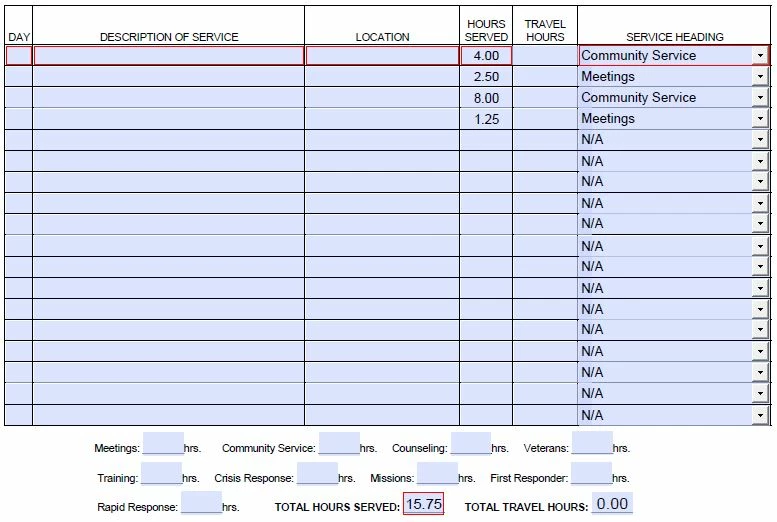

I have three field types I need to do a calculation on. I have 18 possible entries on a form that is basically a timesheet. User enters hours worked and chooses the service they performed from a drop-down. At the bottom of the form, there is a text box to display the total hours worked for that activity. There are 9 of these boxes, one for each service category. What I want to do is have the form calculate these totals. For example, John Smith did 4 hours on day 1 of the month doing Community Service. On Day 10 he also did Community Service. That would be two of the 18 services performed rows. There arw 18 rows that contain the Hours served and the type of service. This total would need to be added to the Community Service total box. There remain 16 rows that could be any of the other 8 service types.
To sum it up, I want to be able to have the one service type add up the total hours from the total hours fields in the two rows that are Community Service in this example. Keeping in mind this will need to be done for each service type that may appear in the form. We also have no way of knowing ahead of time what order entries will be made, as they take place on different dates.
Correct answer try67
to demonstrate the cells and info I want to calculate that I can't find an existing script that works that will accomplish this, after three days of searching. This should be simple, but I'm not a programmer. The
The category list is ServiceHeading1-18. The hours worked is HoursServed1-18. The boxes for the total by service/task are labeled/named as shown.
Thanks for any help you can offer on this auto calculation scri[ting.
Here's an example of how to calculate the total time for Meetings, for example:
var total = 0;
for (var i=1; i<=18; i++) {
	if (this.getField("ServiceHeading"+i).valueAsString=="Mettings")
		total+=Number(this.getField("HoursServed"+i).valueAsString);
event.value = total;

I have searched for hours and cannot find a solution. I do not know where to begin on either step
First question is how to get the Items in the list to be recognized individually so they can be tallied by row with the Time entry column on that row. I assume this is the first step you mentioned. I am using number fields and time spent per activity is entered 1.00 for example, in 15 minute increments (.25, .50, .75). on the day 1 of the month (a single row, row 1) we have 1 hour of community service. on day 3, we have 2 hours of community service (row 3). I want to add hours on row 1 to hours on row 3 to calculate a total community service hours result to populate the community service box at the bottom. This same logic would be used on the other list items like meetings, for example. The key is, it needs to know the difference between meeting hours and community service hours, so I obviously can't just sum the hours column like I did for the total hours for the month.
I have attached a snip of a sample form, leaving out the date and details, just the fields I need to use to do the calculation have sample info.
