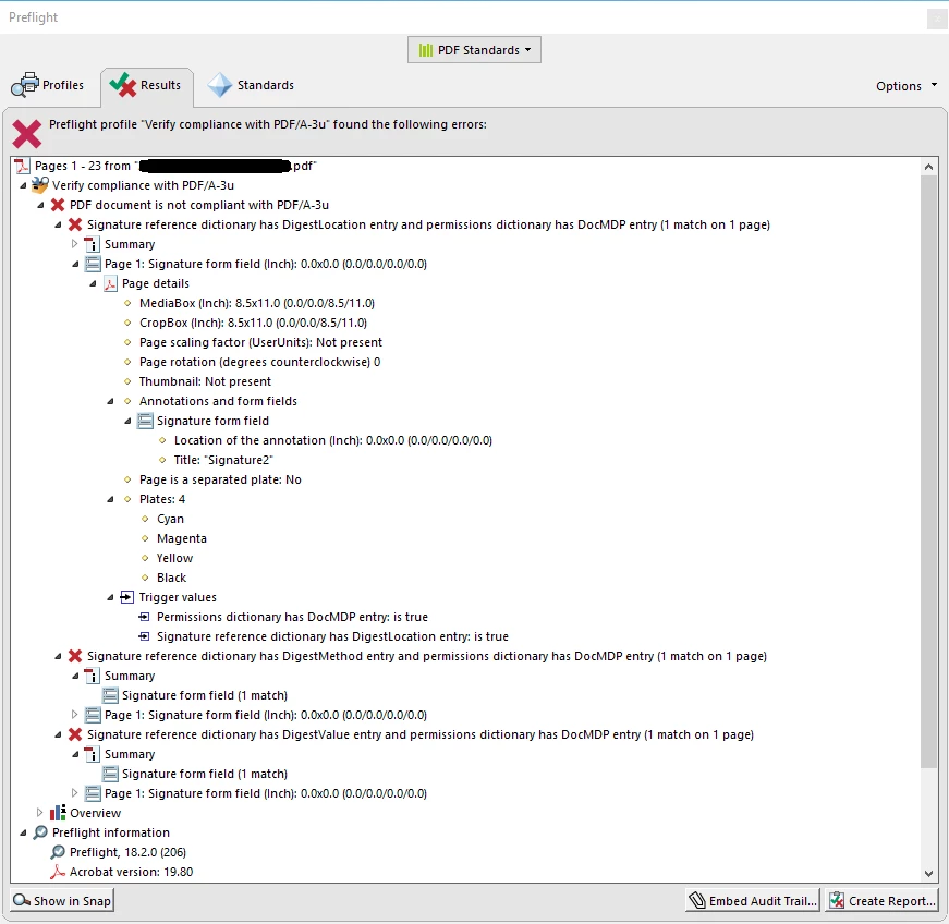

We are using Acrobat Pro DC's preflight feature to convert PDFs to comply with the PDF/A-3u standard. Our next step is to use Acrobat Pro DC to digitally certify the same PDF. Once that is done, Acrobat Pro DC reports that the file no-longer complies with the PDF/A-3u standard.
Here is a screen cap of the preflight indicating the issue.
Is there a way to certify PDF/A-3u files that doesn't break conformance with the standard?
I asked this same question in the PDF standards forum here. The conclusion was that Acrobat Pro DC is breaking the PDF/A-3u standard when it signs the file. Any suggestions as to how we can overcome this issue or is it simply a bug in Acrobat Pro?

Thanks for taking the time to reply to my question. We are able to convert to PDF/A-3u successfully but after certifying the PDF using Acrobat Pro DC, it is no longer compliant with the standard. So, the issue is with the certifying process, rather than with the conversion to the standard.
After speaking with Adobe support, we were able to prove that Acrobat can apply a document signature to the PDF without breaking the standard but not a Modification Detection and Prevention (MDP) signature/certificate. When applying our digital signature in that way, Acrobat is adding a DigestLocation, DigestMethod, and DigestValue to the signature references dictionary. That's not permitted by the PDF/A-3u standard. Do you know of a way to prevent Acrobat from doing that?

Sorry to say but there is not much can be done about it as this behavior is as designed.
-Shivam
