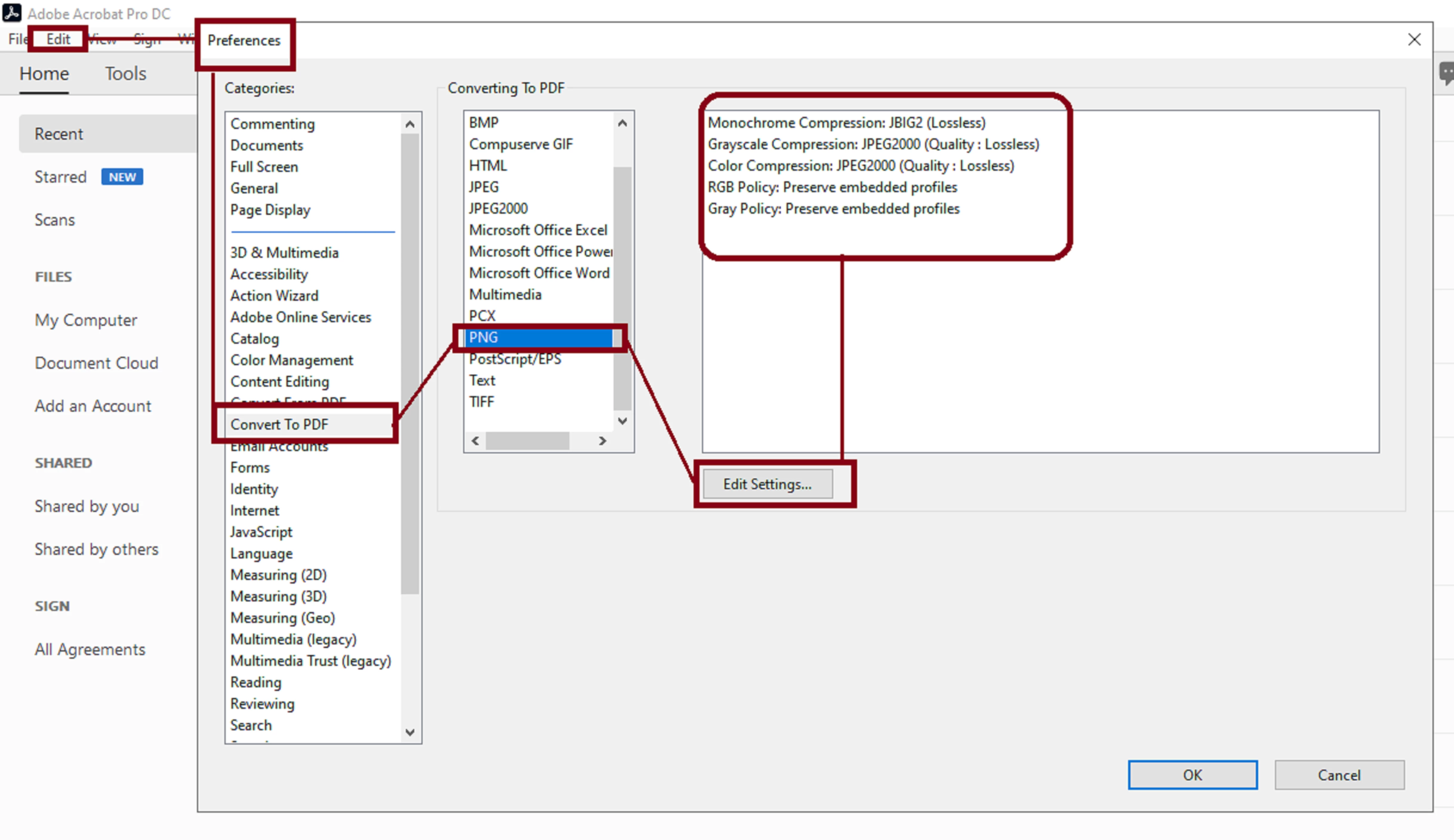

  • The settings and preferences customizations shown throughout the next set of slides didn't take me more than 30 seconds; that  is what I meant in my prior reply.
  • In Edit-->> PERFERENCES-->> Convert To PDF click on "Edit" button and set the following preferences following the slides:

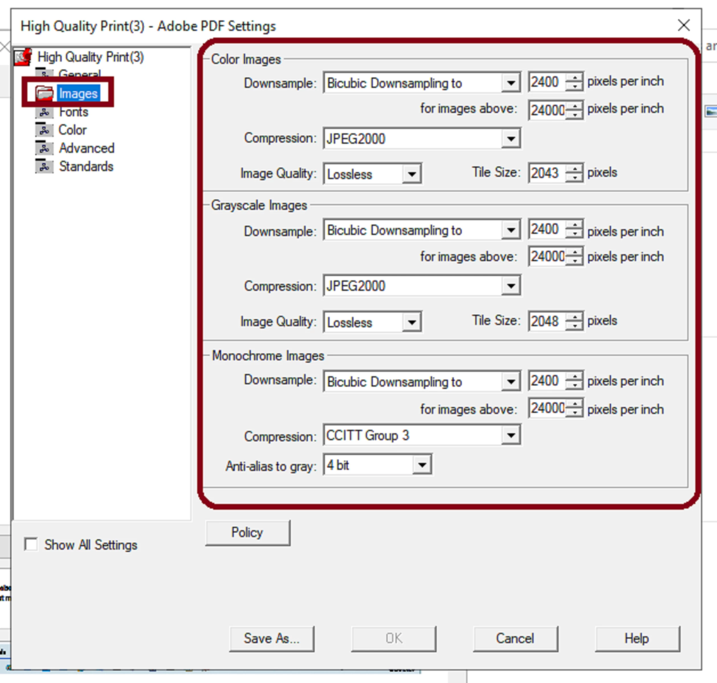

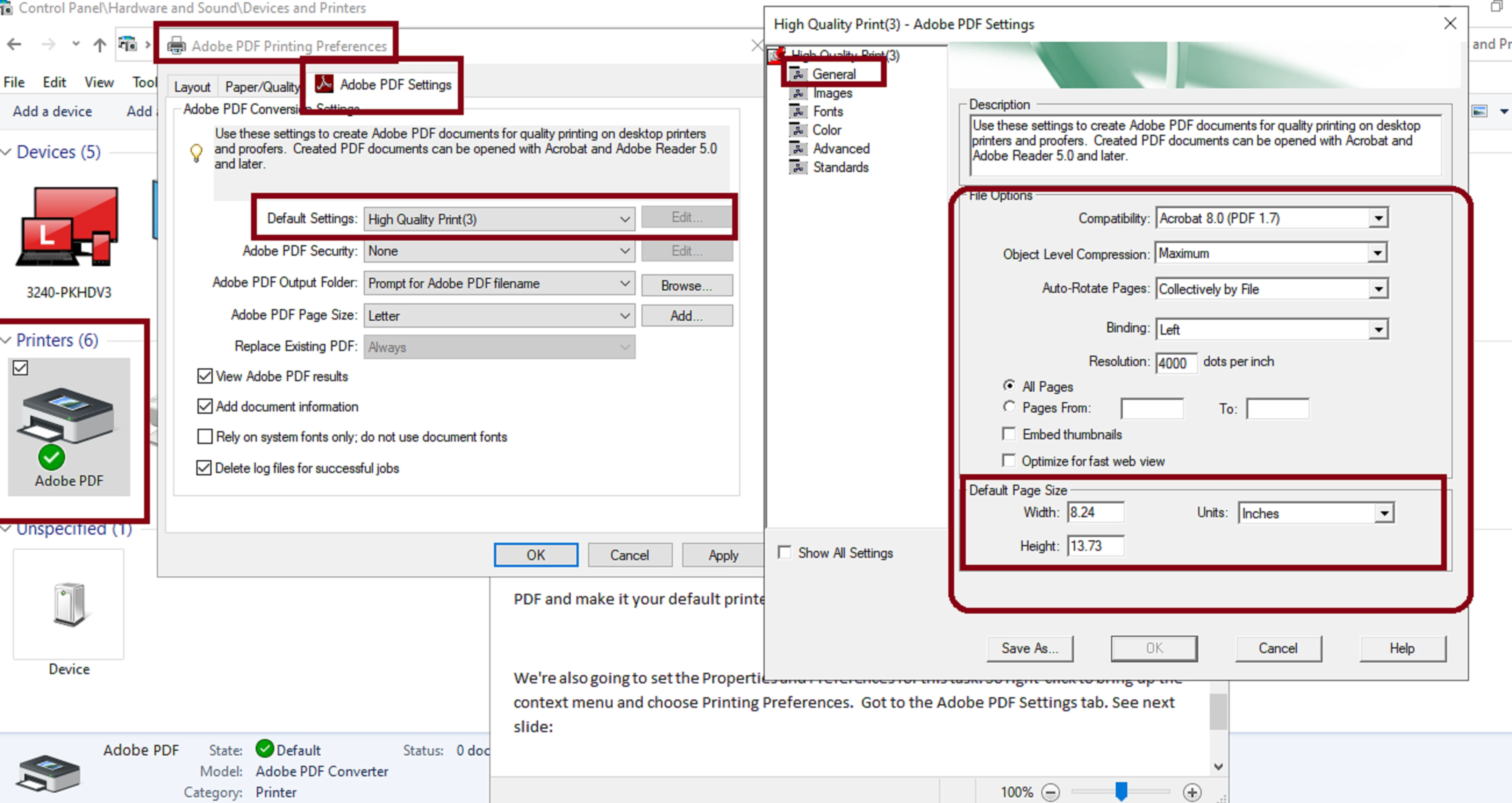

  • In your MS Windows 10 goto Control Panel-->> Devices and Printers -->> right-click on Adobe PDF and make it your default printer.

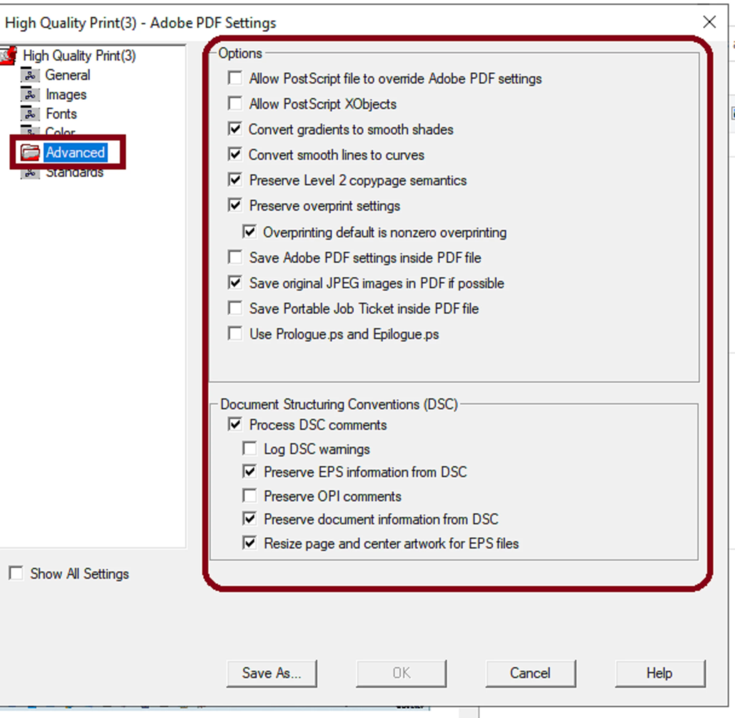

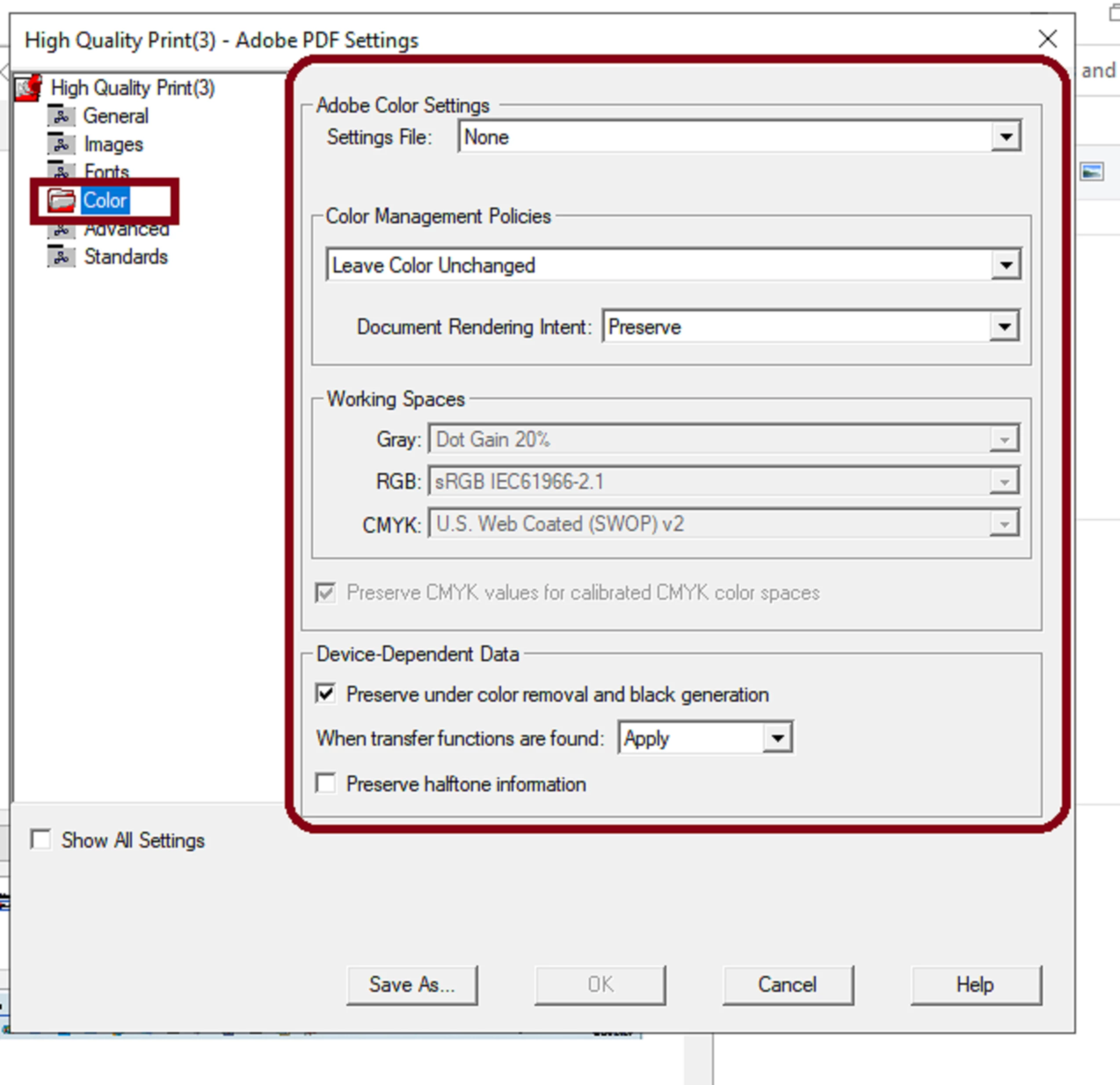

  • We're also going to set the Properties and Preferences for this task. So right-click to bring up the context menu and choose Printing Preferences. Go to the Adobe PDF Settings tab. See next slides and adjust the settings on your end in the same way they're shown:
  • Once you've customized the High Quality print settings click on "Save As" and save this configuration with a new name (in my example I am using "High Quality Print(3)").
  • Taking this time to adjust all of these settings will save you time later as we proceed to the actual printing to a PDF file

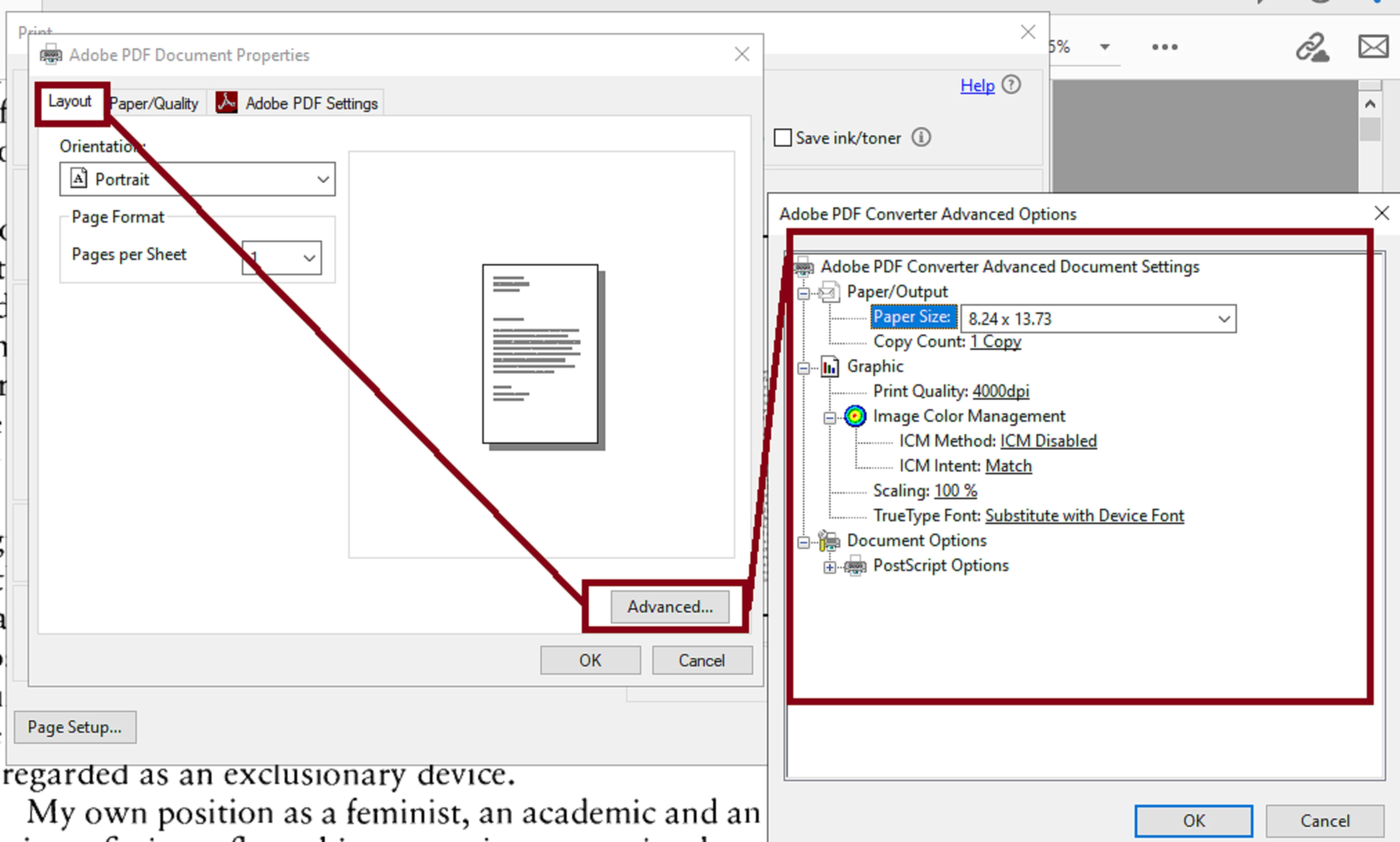

  • In my next slide, you can see that I already customized an entry for the page dimensions that you're inquiring about.
  • The slide following this one shows how to properly customize the "Papaer Size in MS Windows 10".
  • Now, in the Control Panel , go to "Print Server Properties"-- in the Forms tab select the botton below "Change Form Settings".

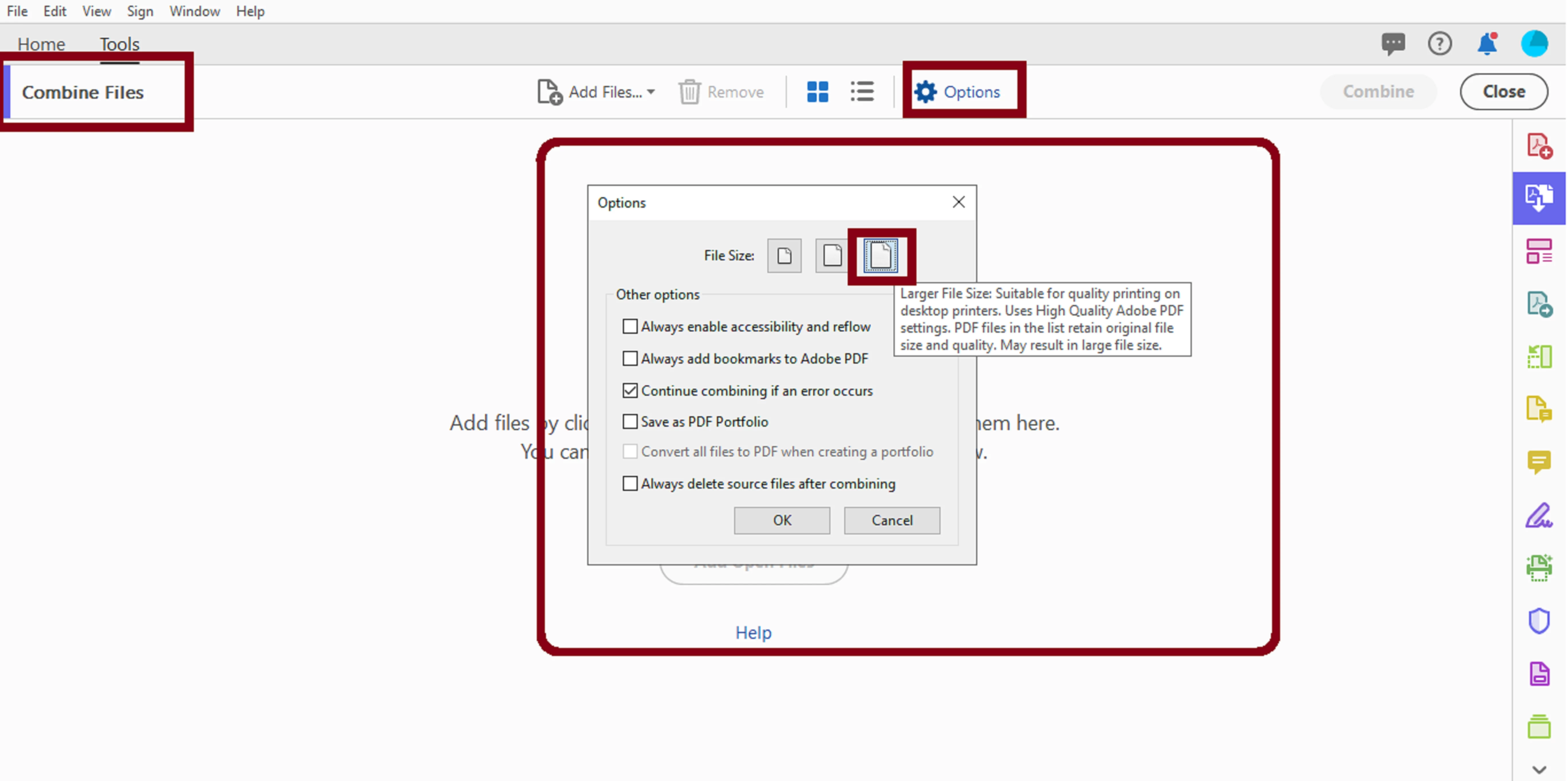

  • In Acrobat, go to File--> Create-->>Combine Files into a single PDF---> Add Files.
  • I chose all of the 200 image files at ince  from the folder that I saved them in
  • With the "Combine Files" tool  opened, I also clicked on the "Options" icon and selected the option for "Large files"; see the next slide:
It took Acrobat less than 8 seconds to pull all of these files up and into a single binder altogether. And when I clicked on the "Combine" button it took about 2 minutes to process 150 images to PDFs. The binding job started at 4:55AM in my time zone; the file binding task concluded at 4:58am.
That is a total of 200 (very large) .PNG image files that Acrobat processed in under 3 minutes.

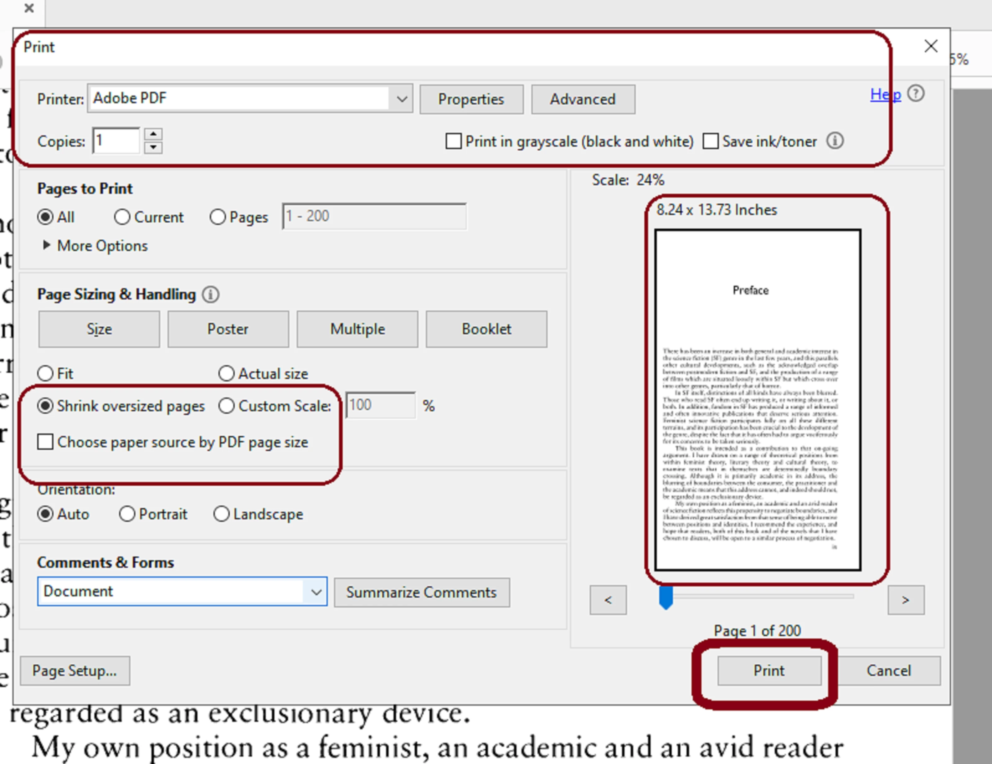

So for the last step ------>>>>  Let's PRINT!
Since it only took me less than 30 seconds to configure my printing preferences  (to obtain exact quality results) , all I had to do in Acrobat was to click on File--->> Print---> and adjust the following settings manually in the printing dialogue box:
  • So,  select "Shrink Over sized Pages"
  • Then Go to Properties---> click on Adobe PDF Settings.
  • In the defaut settings, select from the drop down the customized High Quality Print settings that we've created earlier;  do the same for the "Adobe PDF Page Size",  which we also customized earlier.
  • Select : 8.24 x 13.73  See next slide:

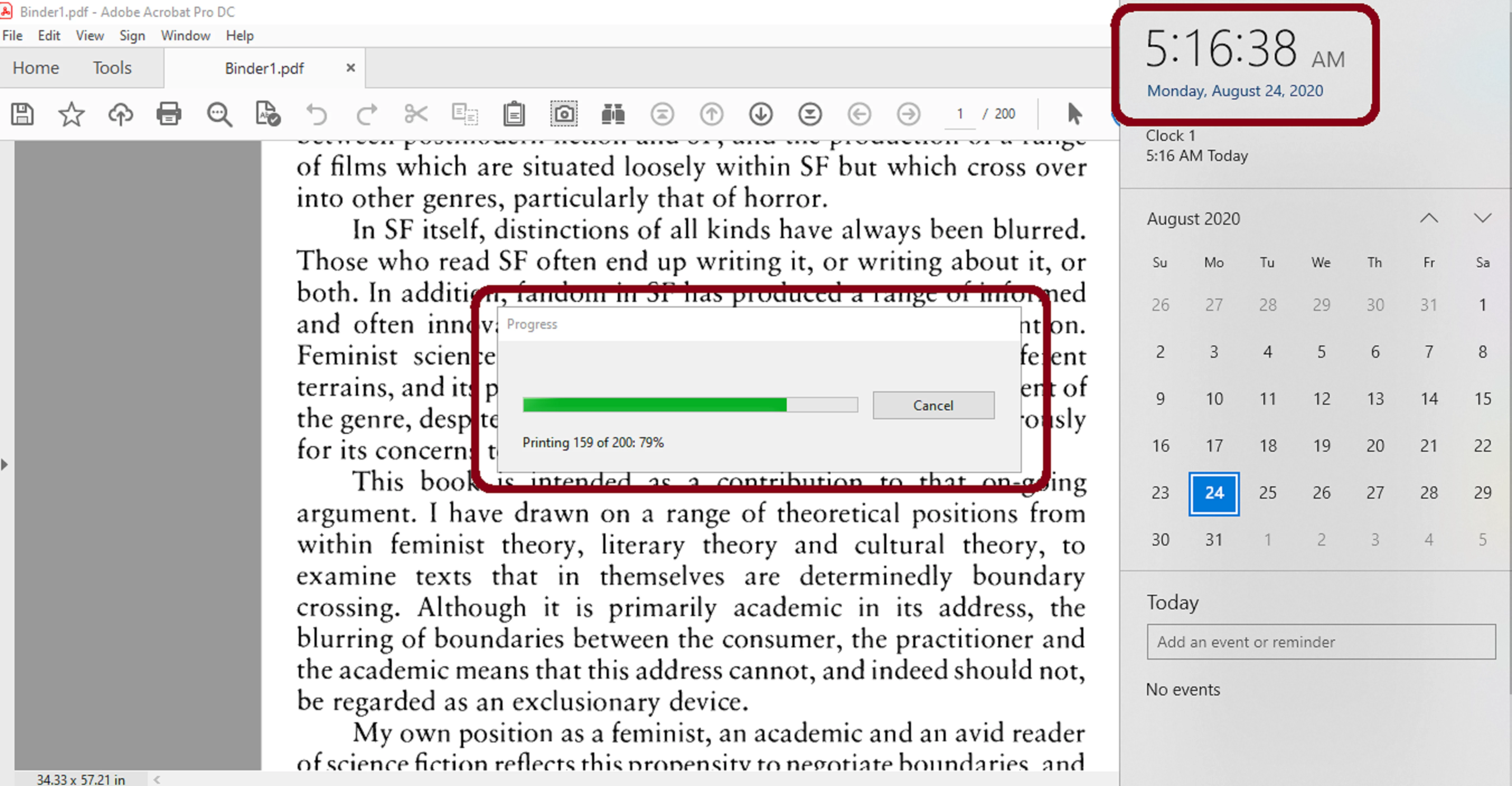

Print Job started at 5:14:34 am.
Print Job finished at 5:17am.
So, these are my overall times to accomplish all of these tasks:
  • Configure my printing options : 30 secomds  plus another 20 seconds to set the page dimensions in the Print Server Properties
  • Combined all image files together in Acrobat:  3 minutes
  • Print a  200 pages long PDF to a new page size without messing too much with downsampling settings, nor using third-party software of any kind: about another 3 minutes
  • Total time: 6 minutes and 50 seconds executed in a crappy desktop computer .

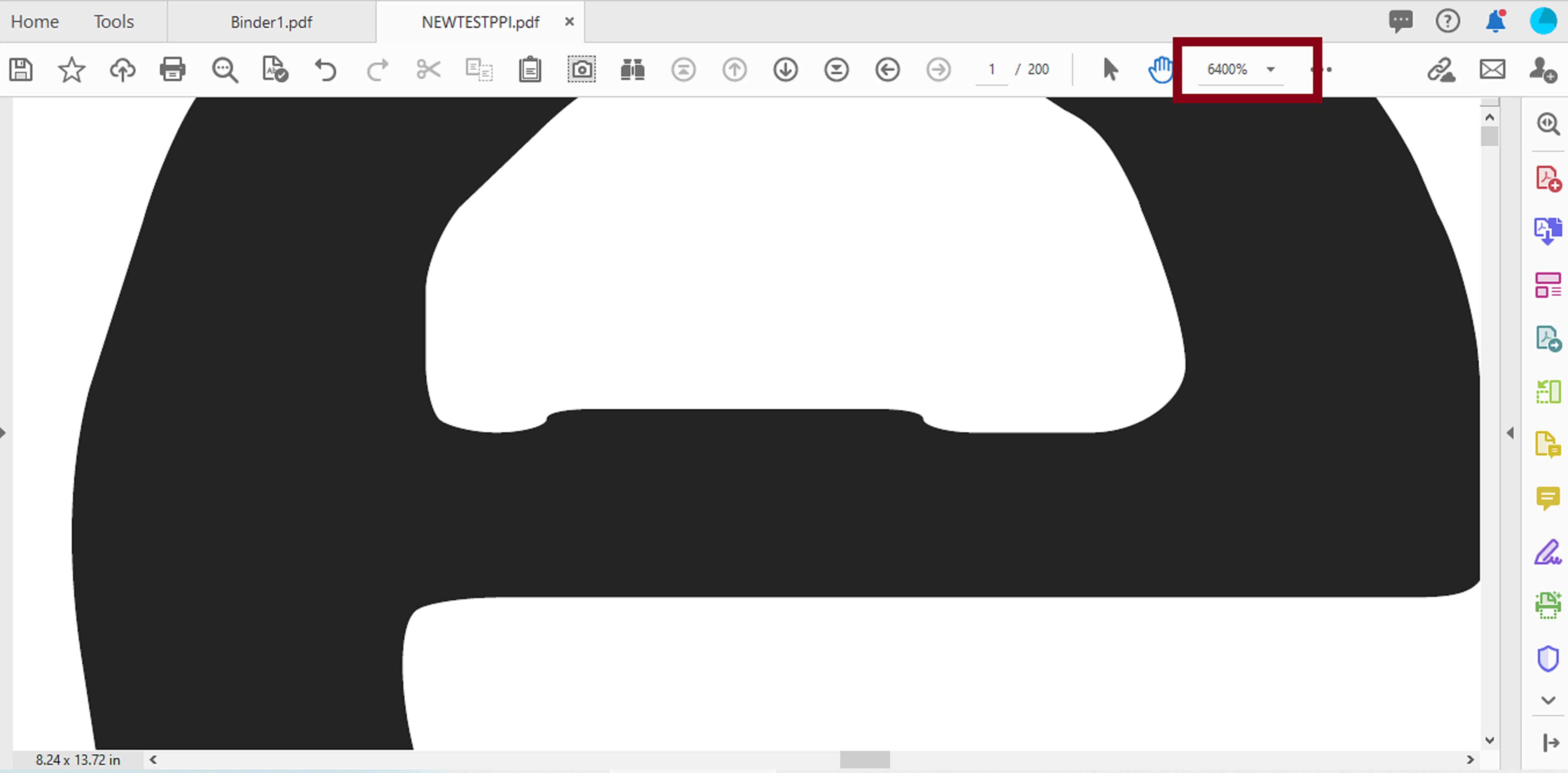

Here's the resulting PDF:
Compare the original file with the result below zoomed in at 6400%.
As you can witness, there is no pixel distortion; the result is identical to the original .PNG image file resolution.

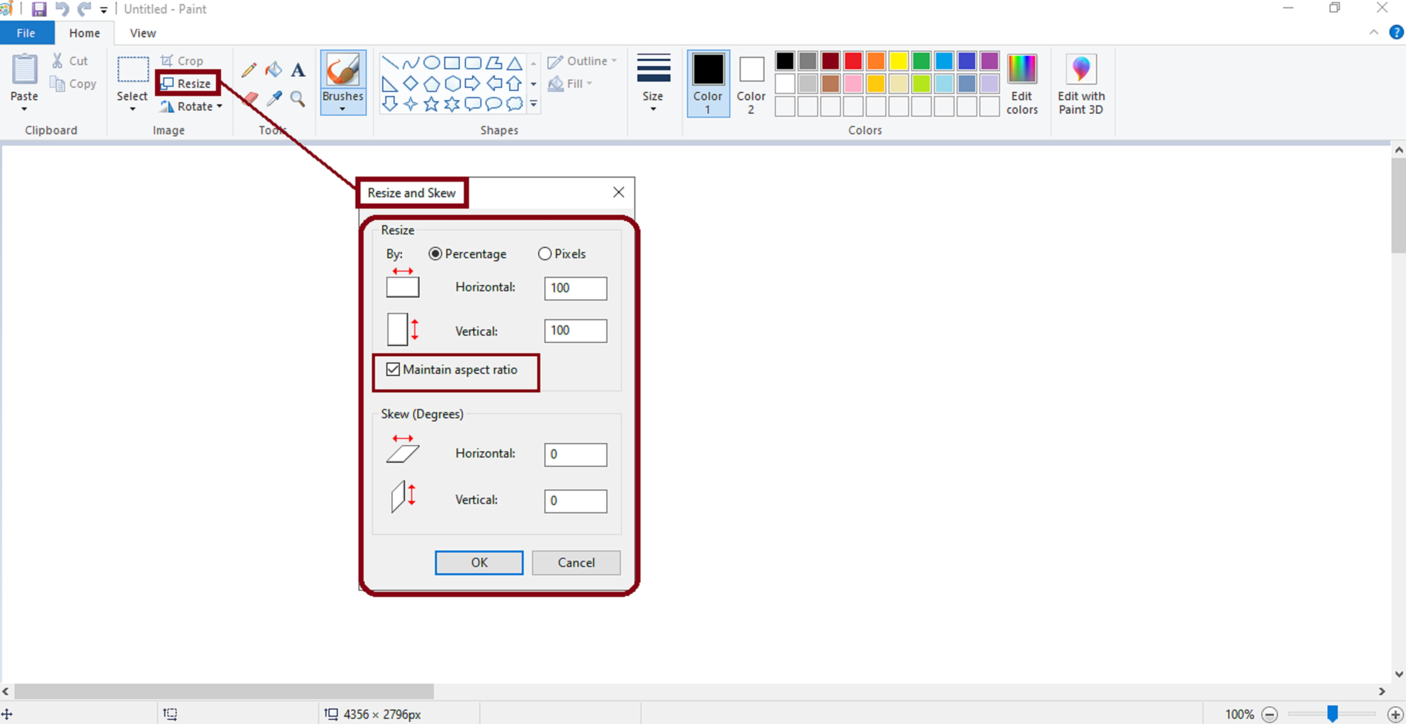

Instead of fighting the DPI with Image Magik you can resize and skew an image very easily using MS Paint.   See slide below:
You can test the resizing of one of your images with MS Paint first . Then observe and keep track of the Horizontal and Vertical pixels.
Once you find a suitable size test the export to PDF and if it looks good (the way you intend it to be) then you can use the the "Mail Recipient" method in MS Windows 10 to batch reduce  all your image files at once to the desired size.
