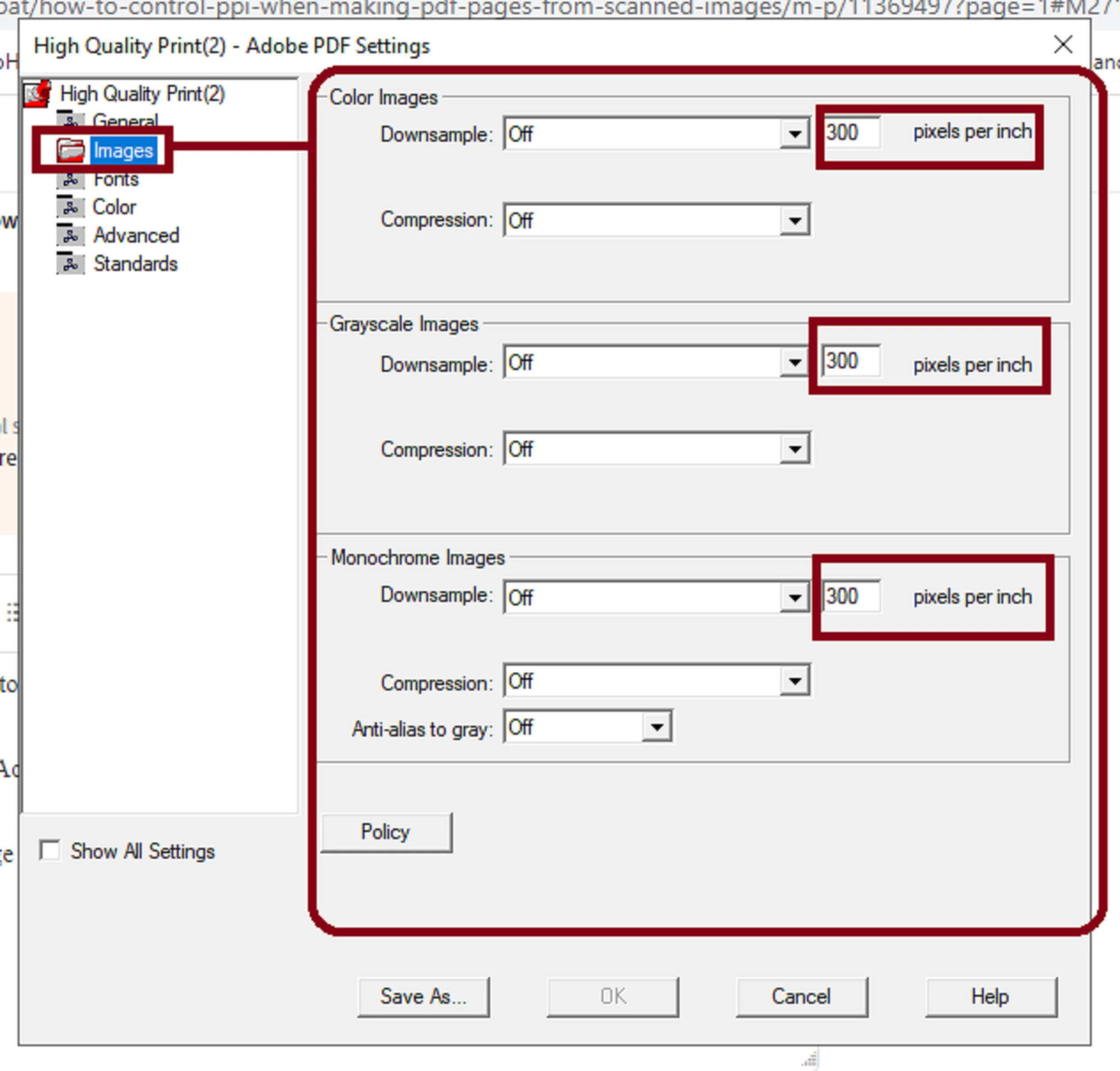

  • The settings and preferences customizations shown throughout the next set of slides didn't take me more than 30 seconds; that  is what I meant in my prior reply.
  • In Edit-->> PERFERENCES-->> Convert To PDF click on "Edit" button and set the following preferences following the slides:
  • In your MS Windows 10 goto Control Panel-->> Devices and Printers -->> right-click on Adobe PDF and make it your default printer.
  • We're also going to set the Properties and Preferences for this task. So right-click to bring up the context menu and choose Printing Preferences. Go to the Adobe PDF Settings tab. See next slides and adjust the settings on your end in the same way they're shown:
  • Once you've customized the High Quality print settings click on "Save As" and save this configuration with a new name (in my example I am using "High Quality Print(3)").
  • Taking this time to adjust all of these settings will save you time later as we proceed to the actual printing to a PDF file
  • In my next slide, you can see that I already customized an entry for the page dimensions that you're inquiring about.
  • The slide following this one shows how to properly customize the "Papaer Size in MS Windows 10".
  • Now, in the Control Panel , go to "Print Server Properties"-- in the Forms tab select the botton below "Change Form Settings".

So for the last step ------>>>>  Let's PRINT!
Since it only took me less than 30 seconds to configure my printing preferences  (to obtain exact quality results) , all I had to do in Acrobat was to click on File--->> Print---> and adjust the following settings manually in the printing dialogue box:
  • So,  select "Shrink Over sized Pages"
  • Then Go to Properties---> click on Adobe PDF Settings.
  • In the defaut settings, select from the drop down the customized High Quality Print settings that we've created earlier;  do the same for the "Adobe PDF Page Size",  which we also customized earlier.
  • Select : 8.24 x 13.73  See next slide:
