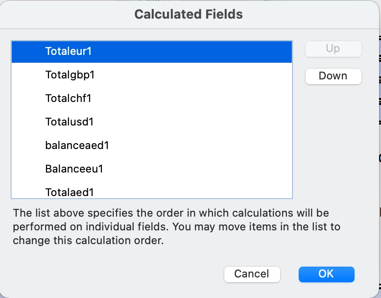

Hi everyone,
I am trying to create a running balance (totalaed1 amount to be added to current balanceaed1) using to the following code
event.value = 0; if (this.getField("Totalaed1").value >= 1) event.value = this.getField("Totalaed1").value - this.getField("balanceaed1").value;
For some reason the result doesnt match.
Thanks for your help

If result doesn't match it's probably field calculation order, while in 'prepare form' tool click on 'More' then 'set field calculation order' and make sure that field where you use script is under "Totalaed1" and "balanceaed1" fields.

I ended up in calculated fields but I don't have the knowledge to know the correct order.
Nesa Nurani
January 26, 2022
Move field where you use script all the way down so it is below "Totalaed1" and "balanceaed1".
