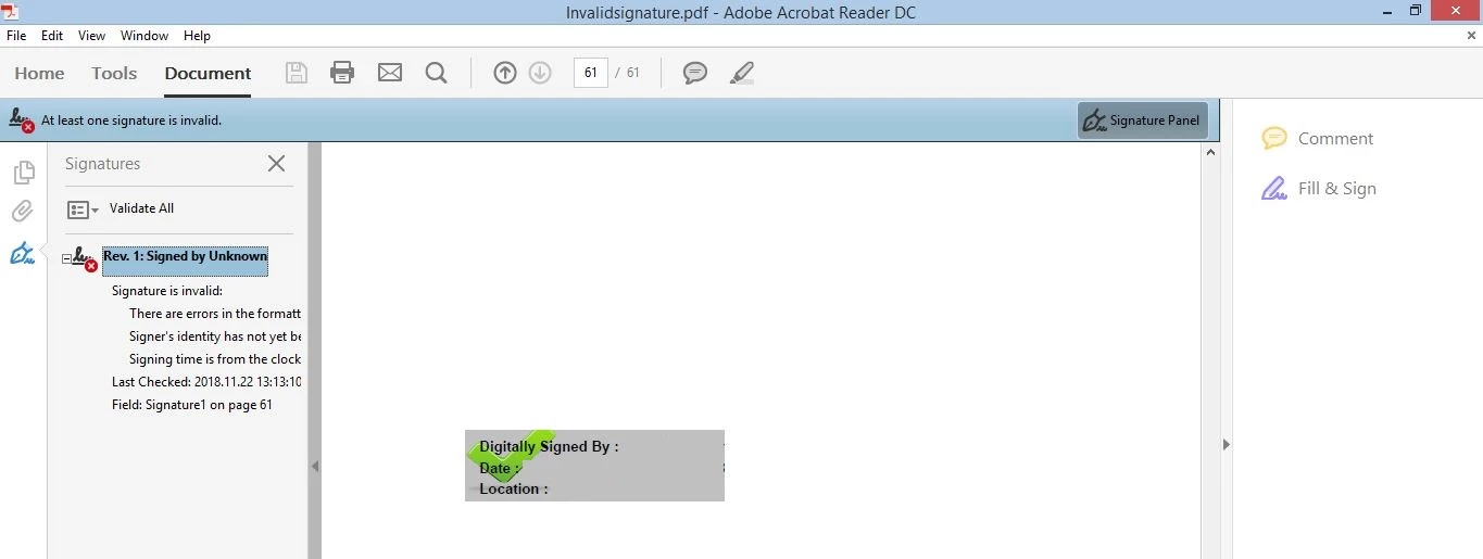

How to delete digital signature for PDF file programatically.
Deleting one signature from PDF file, other signatures in the same  PDF file are becoming Invalid

November 23, 2018
API Used: PDFBox2.0.4
PDF signed with Multiple signatures.
We are able to remove the signature, but it makes other signatures invalid in the PDF.
Any help is appreciated.
