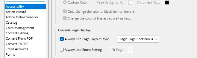

How to enable scrolling by default. I'm using Acrobat DC. Every time, when I open document I chose in view -> Page Display -> Enable scrolling. It works, untill I close Acrobat. When I open acrobat next time, in order to be able to scroll I should do this set up again. How to make this setup stick?
    Correct answer Souvik Sadhu
    Hi @miket24434990,
    Hope you are doing well. Thanks for writing in!
    Acrobat, by default opens the PDF in the view that has been set at the time of creation.
    You can override the settings by going to Preferences-> Accessibility-> check the box saying "Always use Page Layout Style" and change it to continuous.
    Hope this helps.
    -Souvik

    This does not work UNLESS the Accessibility setting is off or matches. Accessibility setting negates anything this flow is set to do! You should always add that caveat to this step flow if you're posting it.
    Souvik Sadhu
    November 6, 2024
    @jim_2541,
    Thanks for pointing it out.
    Adding a screenshot for the preference you mentioned to ease out navigation for future users:
    -Souvik
