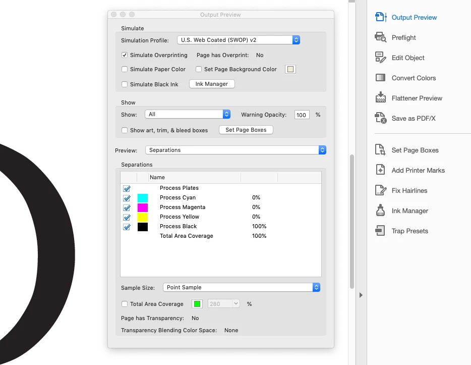

Are you using Acrobat DC? At the top of your screen you should see a Tools tab, click it and then find Print Production, then Output Preview. (see the previous screen shot), in the Output Preview panel, select Show: All and Preview: Separations. This should work with both vector and raster color values. If it's not working, try closing and re-opening your PDF. I have added Output Preview to my tool bar for quick access.

Tools> Print Production> Output Preview
Move the cursor over a color to identify it.

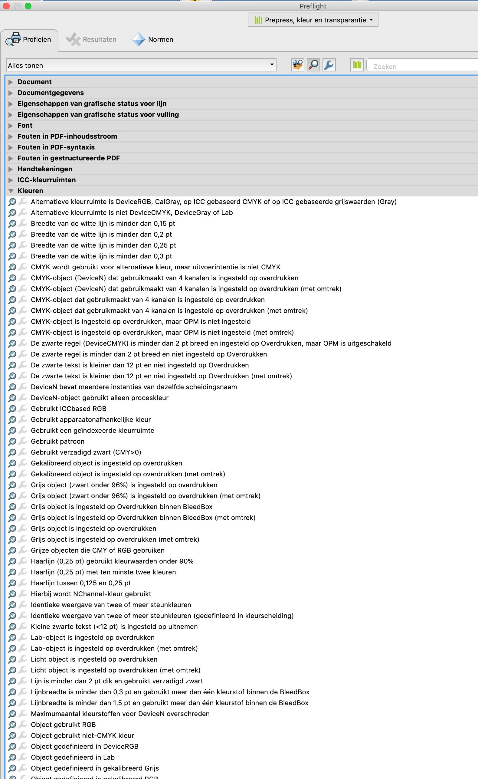

You can use the Preflight tool to get a list of all the colors used in the file. Open it via Tools - Print Production - Preflight (or just search for "preflight" if you're using Acrobat DC Pro) and then search the Profiles list for "list" and you'll see several options. You can also create your own Profiles, if the built-in ones don't do what you need, but that is more complicated.

I'm not an expert in this, so this is the only thing I find...
so far I see no list with the used colors.
is it possible to make a screenshot where I have to look?
