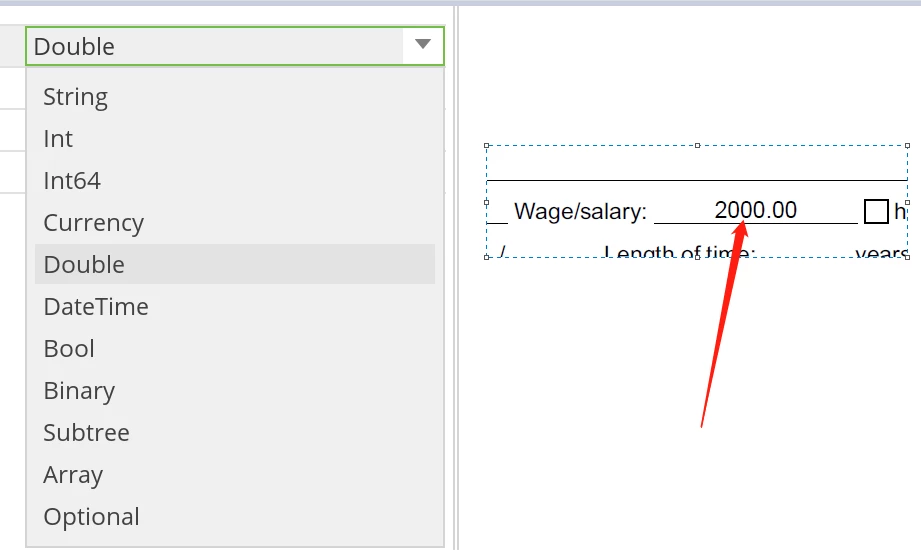

Thanks for your reply. I am a start leaner of JS. And I am working on a 3rd part design tool which support JS.
I noticed the 'event.value = util.printf("$%,0.2f",event.value);' somewhere. But I don't know how to use it or how to connect with the field 'Salary' I already defined.
In the design tool, I can define it as any type of below, I chose dobule, as a result, it shows up 2000.00 but no comma and $ symbol. So I need to do with script to format the field Salary, but I how to connet the code you posted with this Filed.
try67
February 22, 2023
Use Acrobat to do it. There you will be able to simply select the Currency option under the Format tab and it will take care of the code for you. No need to re-invent the wheel...
