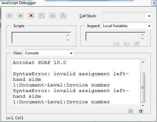

When I save and reopen a invoice number does not show. This is what (Ctrl +J) shows:
Thank you for helping me figure this out.
My bad... The code should be:
this.getField("Invoice No").value = util.printf("%06d", Math.floor((Math.random() * 1000000) + 1));
