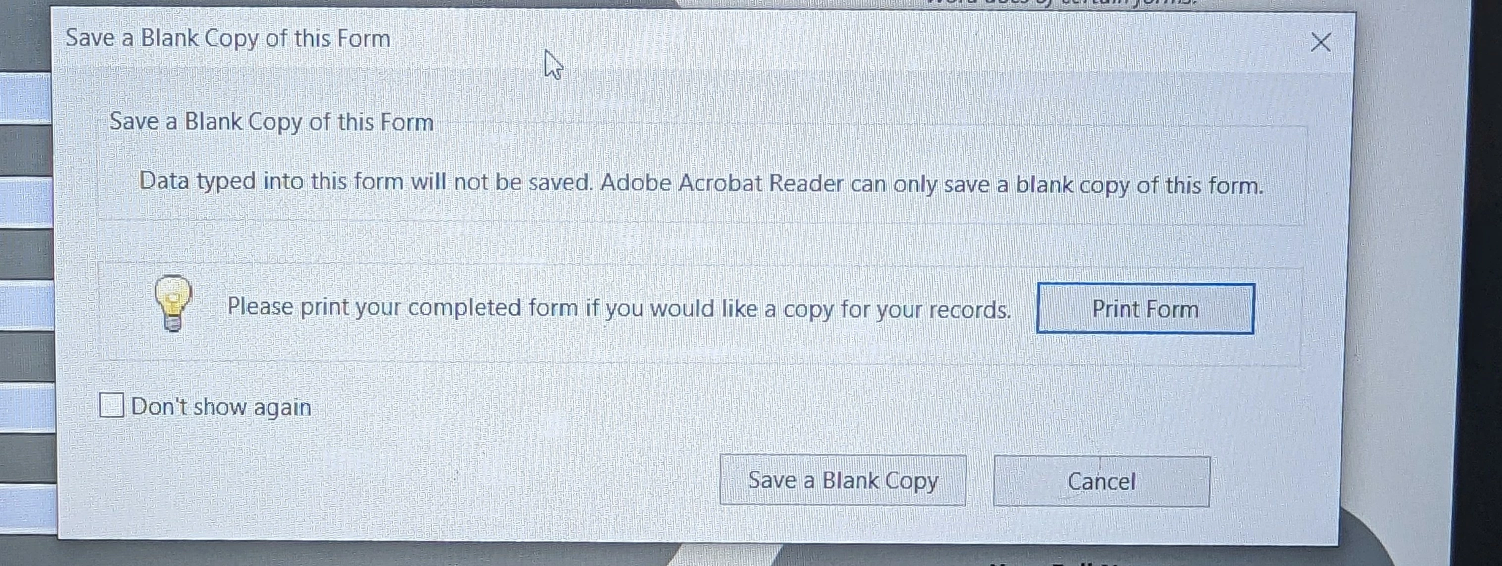

Yep! I did try that. On Adobe Reader, once opening the attached Reader Extended PDF, this is what shows up when I click "Save As."
Using Reader it's not possible to modify an attachment (unless a very special right is applied, which is not possible with just Acrobat). You have to save it as its own file on your computer first, then close and re-open it. If you do that, though, the script is not going to work for that file any longer, I'm afraid.
