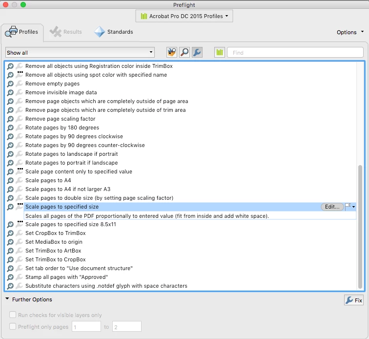

I am making a .pdf in Acrobat DC from combined .jpg images of documents photographed with an iphone. How can I format the .pdf so that all the pages are letter size?
Luke Jennings3
August 6, 2020
You could use an Acrobat preflight fixup to specify the page size (Tools> Print Production> Preflight> Fixups (blue wrench icon), type "scale" in the search field. You can also duplicate and re-name the existing preflight and then edit it to access more options.
Another option would be to create a multipage InDesign file, place the images into each page, cropping and re-sizing as needed, then export to a new PDF.

You can select one of the existing preflights, duplicate it, and edit it to make it do what you need.
Thank you.  This is ridiculously complicated but glad it worked.

Luke Jennings
July 28, 2016
Do any of the pages have crop marks and/or bleed? The trim size for all of the pages might be 8.5x11, but the pages with crop marks will have a larger media box, and look larger on screen. In Acrobat, you can go to Tools> Print Production> Preflight> (select the wrench icon for changes)> Pages> Set Crop Box to Trim Box.
You can also place all of the pages into InDesign and export to a new PDF at the desired size.
You can go to File> Document Properties> Initial View> Magnification to select a desired magnification when the PDF is opened, however it won't force different sized pages to appear to be the same size.
