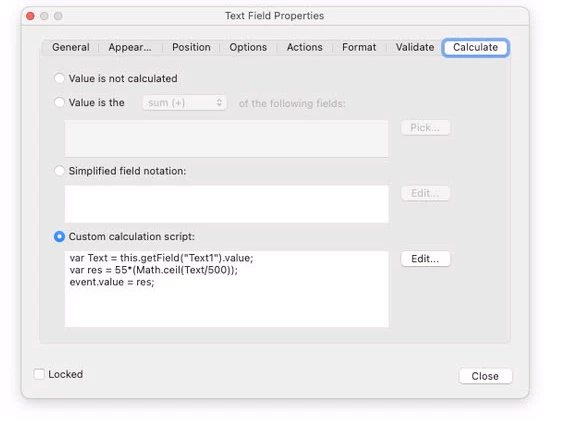

    Copying your code works for me, can you share the PDF or screen shots of how you have added the script so that I can check it is all set up as it should. I used different field names but I copied the code as below

    It seems to be working now. I didn’t even change anything other than saving, closing, and reloading the document for the 10th time. Thank you for trying
