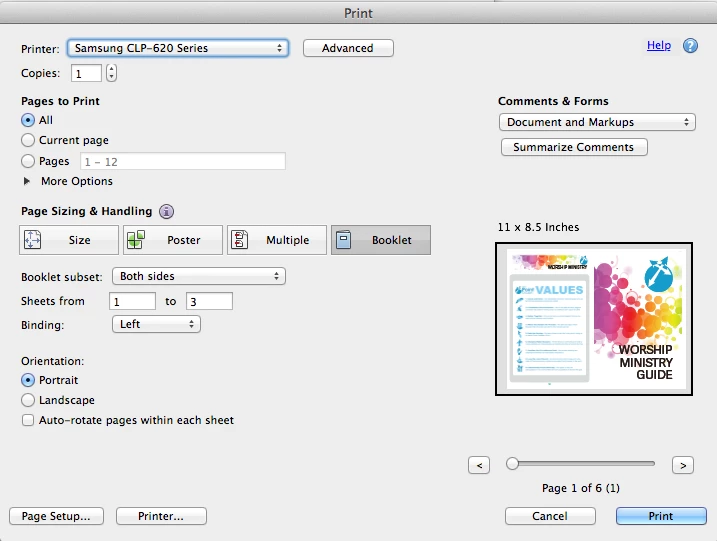

How can I print a booklet at 100%? When I print a booklet from Acrobat, it shrinks it slightly, about 5% or so (which I guessing is scale to fit). But I need the booklet printed at exactly 100%. Is this possible?
I have every version of Acrobat from version 9 all the way up to DC, so I can use whichever one that will get the job done. I am on a mac.

Document Geek
August 21, 2015
Thanks for that, but the option for page scaling is not available when printing a booklet. See below. Am I missing something?
MrTIFF
August 27, 2015
Try:
1. In the Print dialog, click "Page Setup..."
2. In the "Page Setup..." dialog, you may have to create a 'Custom' 'paper size' that has "no margins", or set the margins to zero.
("Margins" here really means "the edges of the printable area".)
3. Back in the main Acrobat Print dialog, click on the 'Size' button, and set the size to "Actual Size" or 100%.
4. Click on the Booklet button, and print your Booklet.
5. Oh, and make sure that there is enough space for your crop marks and bleeds. If not, make sure that marks and bleeds are turned off.
