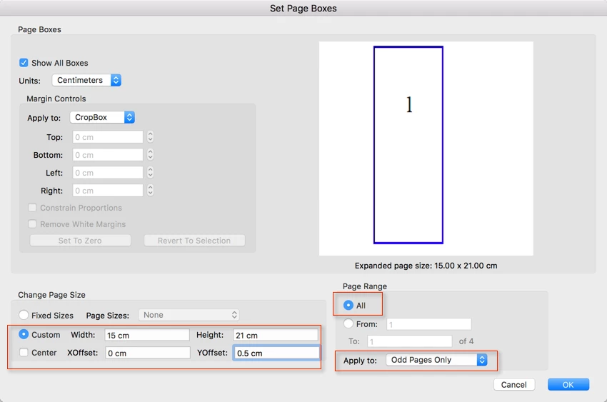

Try this:
Open up the crop tool and make the following selections:
This modifies all odd pages and changes their page size to 15x21cm, and makes sure that the original page image is in the correct spot. Then bring up the crop tool again and use these settings:
Now print your booklet on 30x21cm paper, and the individual pages should be rendered correctly.
