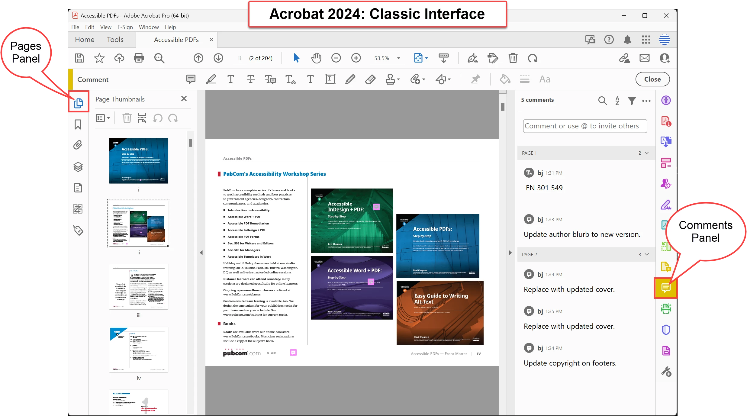

In the "Classic" interface, it IS possible to have the Pages/Thumbnails panel open on the left and the Comments panel open on the right.

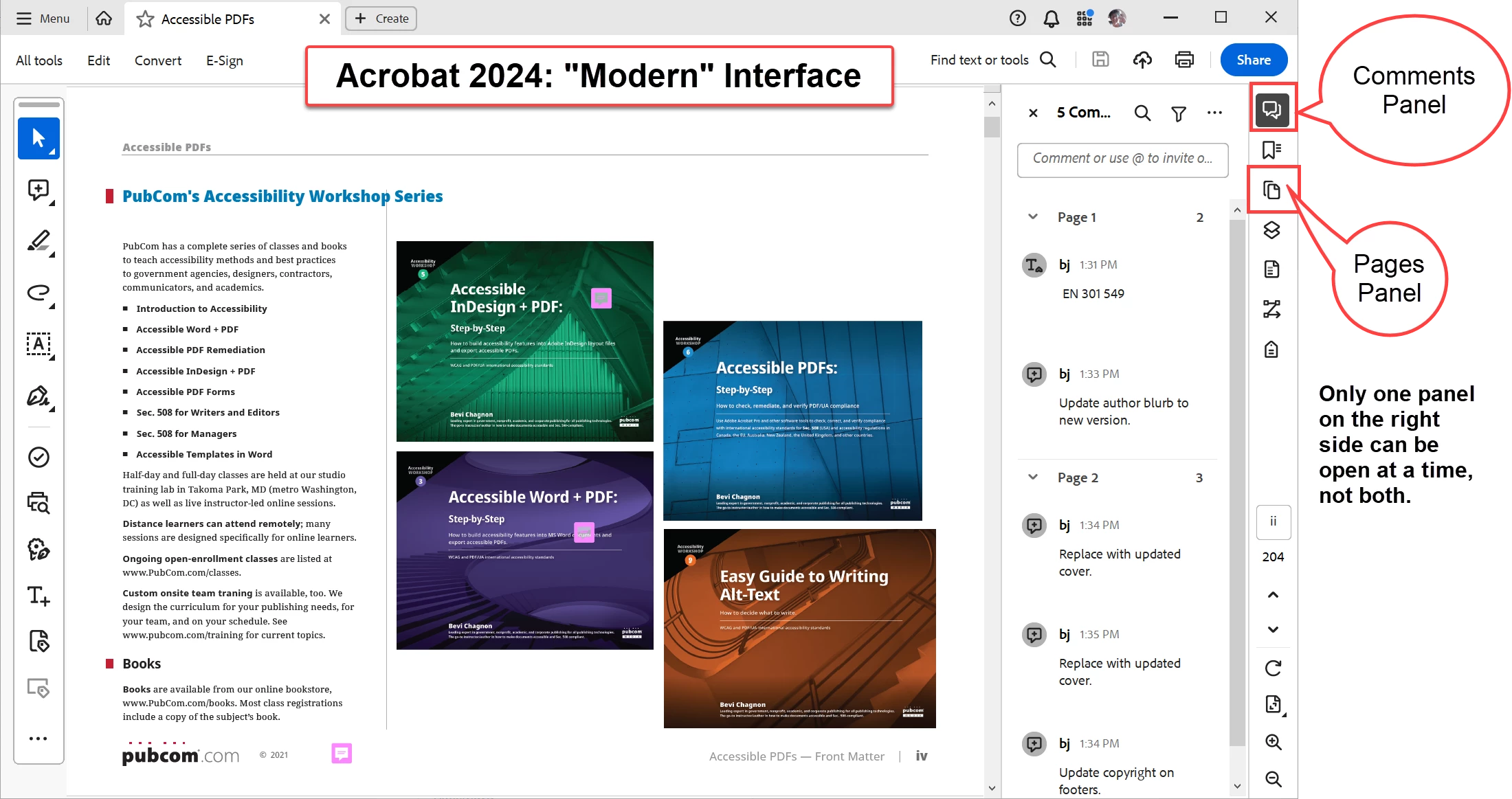

But in the new "Modern" interface, Adobe ganged both panels on the left and only one can be open at a time.
Solution:
The new interface is not ready to be used because of insane shortcomings like this one.
