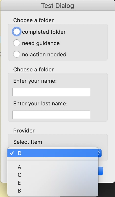

Correct answer bebarth
For me, you have to push all of them one at a time.
Try that in your script:
	// This dialog box is called when the dialog box is created
	initialize: function (dialog) {
		dialog.load({ "usnm": this.strName });
		dialog.load({ "lsnm": this.strLastName });
		this.loadDefaults(dialog);
	loadDefaults: function (dialog) {
		// Liste des couleurs
		dialog.insertEntryInList({"sub1":{"D": +2}});
		dialog.insertSeparatorEntryInList("sub1");
		dialog.insertEntryInList({"sub1":{"A": -5}});
		dialog.insertEntryInList({"sub1":{"C": -3}});
		dialog.insertEntryInList({"sub1":{"E": -1}});
		dialog.insertEntryInList({"sub1":{"B": -4}});
and you will get:
and you will get:
August 2, 2022
Thank you, it worked perfectly!
