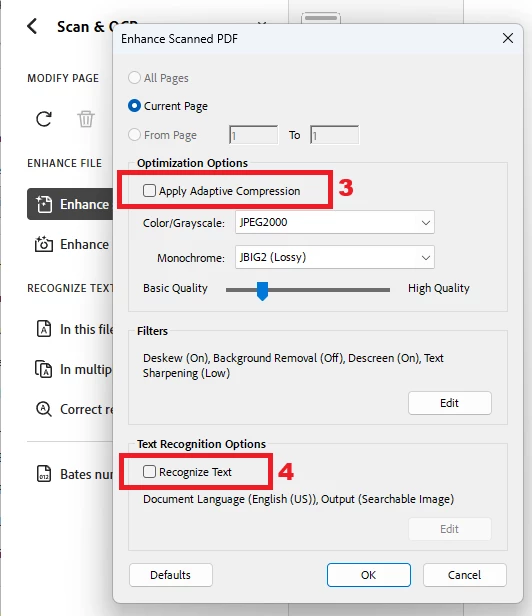

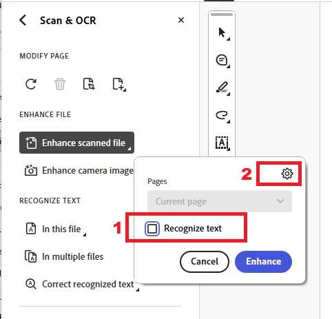

I HAVE FOUND IT (for updated version AUG. 2026)!!!!!
Turn off AUTO-OCR conversion, turn off AUTO-compression of images (thus reducing your image quality), AND turn off the edit and convert (using OCR) on FORM creation (that literally makes “prepare a form WORTHLESS because it doesn’t actually find the form blanks, it tries to edit/convert the ENTIRE form).  HERE ARE THE STEPS (images below).
  1. Under All Tools, click View more, then select Scan & OCR.
  2. Under ENHANCE FILE, click Enhance scanned file, and UNCHECK the Recognize text (Reference Image spot marked #1).
  3. In the same popup, select the gear for settings (Reference Image spot marked #2).
  4. In the settings popup, UNCHECK the Apply Adaptive Compression (Reference Image spot marked #3), and confirm the Recognize Text is unchecked (Reference Image spot marked #4).  Click OK.

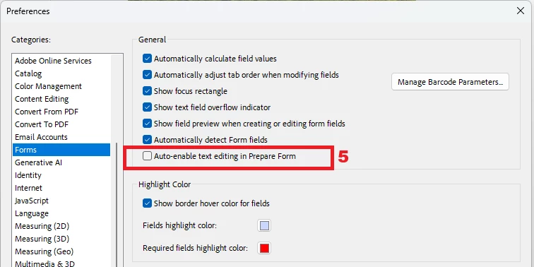

  5. Back in the main PDF, go to the Menu, and select Preferences.
  6. On the left under Categories, select Forms.
  7. Under General, UNCHECK the Auto-enable text editing in Prepare Form (Reference Image spot marked #5).  Click OK.
  8. That’s it!  Now it won’t do dumb things.  You’re welcome. 😁
SPOT 1 & 2
SPOT 3 & 4
SPOT 5
ENJOY!!!  I read thru ALL settings to find this & tested it.  And it worked perfectly.  Applies globally after you shut the current PDF file.  Good luck!
