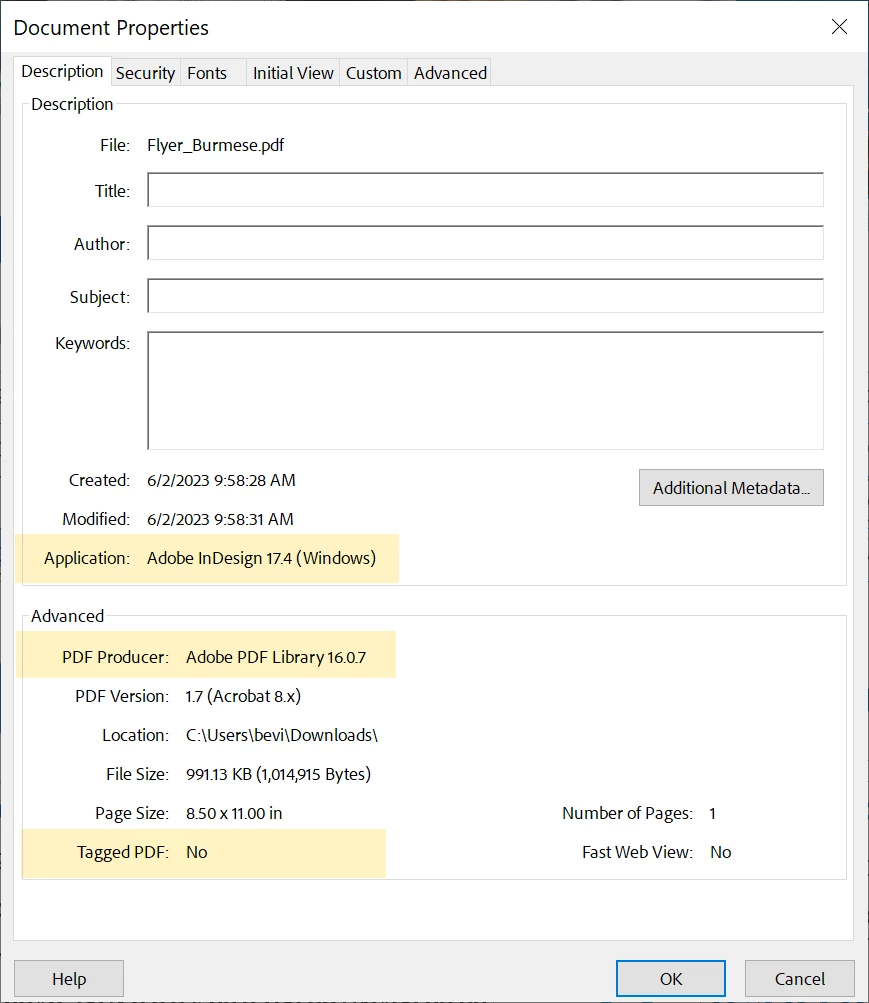

  4. The PDF you supplied is not tagged. Can you give us a copy of a tagged version, as it comes out of InDesign without any extra changes done in Acrobat? This will help us diagnose what's  happening.

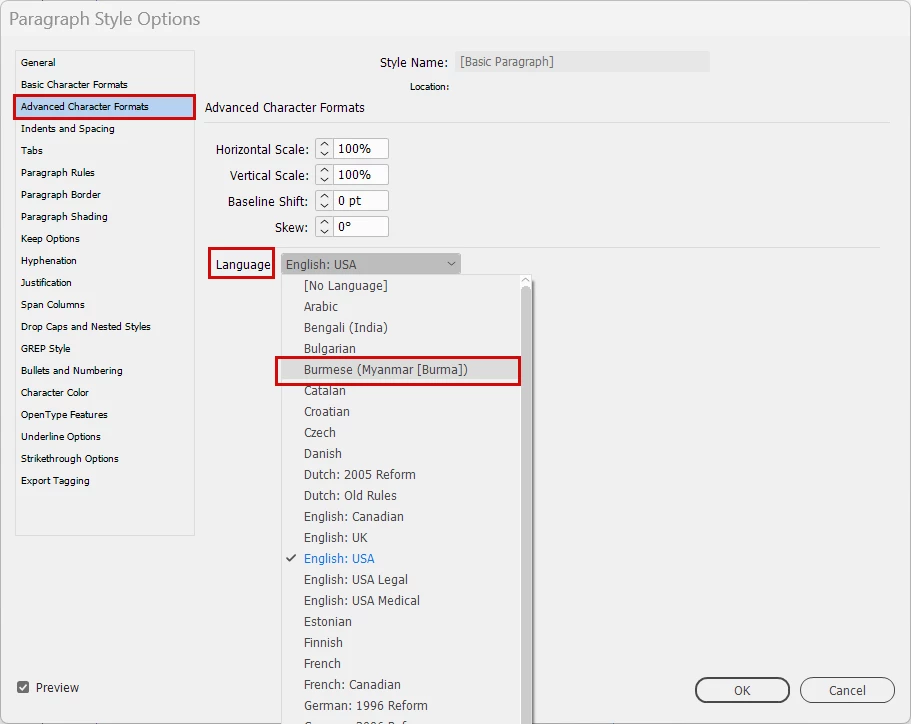

  5. In InDesign, did you set your paragraph style to use Burmese/Myamar?
    In each Paragraph Style used to format Burmese, set the style's language to Burmese.

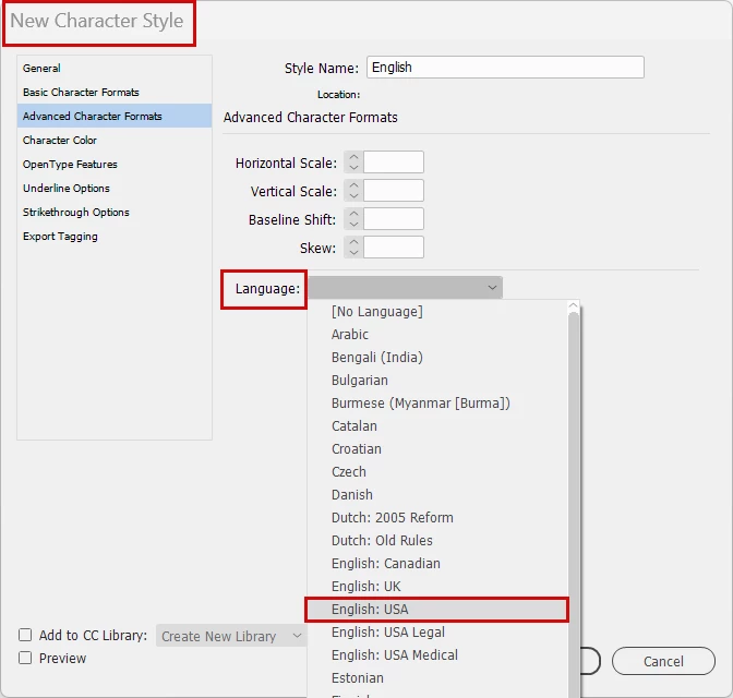

  6. I noticed you have English words within the paragraphs. For those, create a Character Style and set it to English.

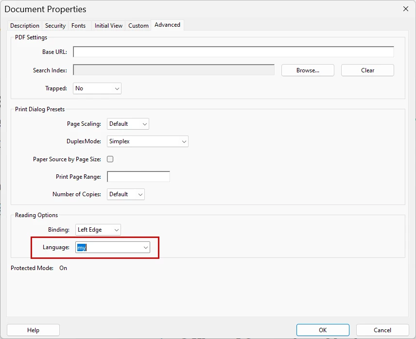

  7. After the PDF is generated, set the PDF's primary language in Acrobat Pro. Since Burmese is not one of the preset languages, you'll have to type in the ISO 639 language code for Burmese/Myanmar — "my".  See the ISO code list at https://en.wikipedia.org/wiki/List_of_ISO_639-1_codes  and also at  https://www.loc.gov/standards/iso639-2/php/English_list.php

What was your source program that originally created the PDF? InDesign?
If so, which version and platform? Need the long build number with dots, not "2023" or "18".
