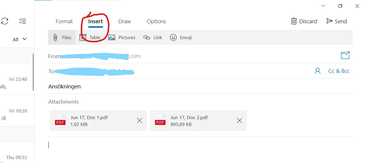

October 2, 2021
Try inserting the files.
